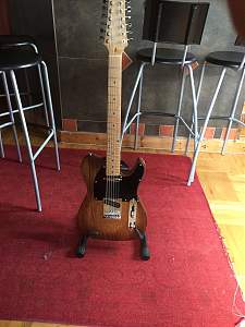

    Did you have a Build diary going PeMe? Would be good to see the beastie!
    I didnt do no build diary but i have this pic of the end result....
