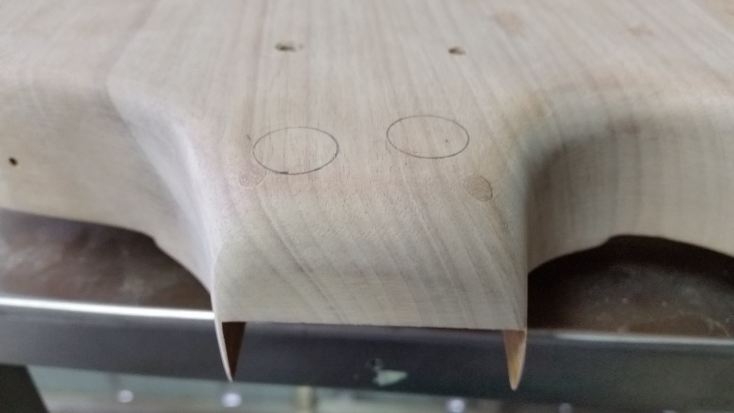

    Next thing is to try and do something about where the body and neck join. I have relatively small hands and the overall size of the join would mean I couldn't get to the higher frets.
ID:	7658Click image for larger version.
    I had some mahogany offcuts from my PBG-2 build and used them to make a pair of plugs for the two holes closest to the end of the body. Ordered a set of ferrules so I don't need to use the supplied plate and started shaping the body under the neck pocket to try to get more reach, still a work in progress.

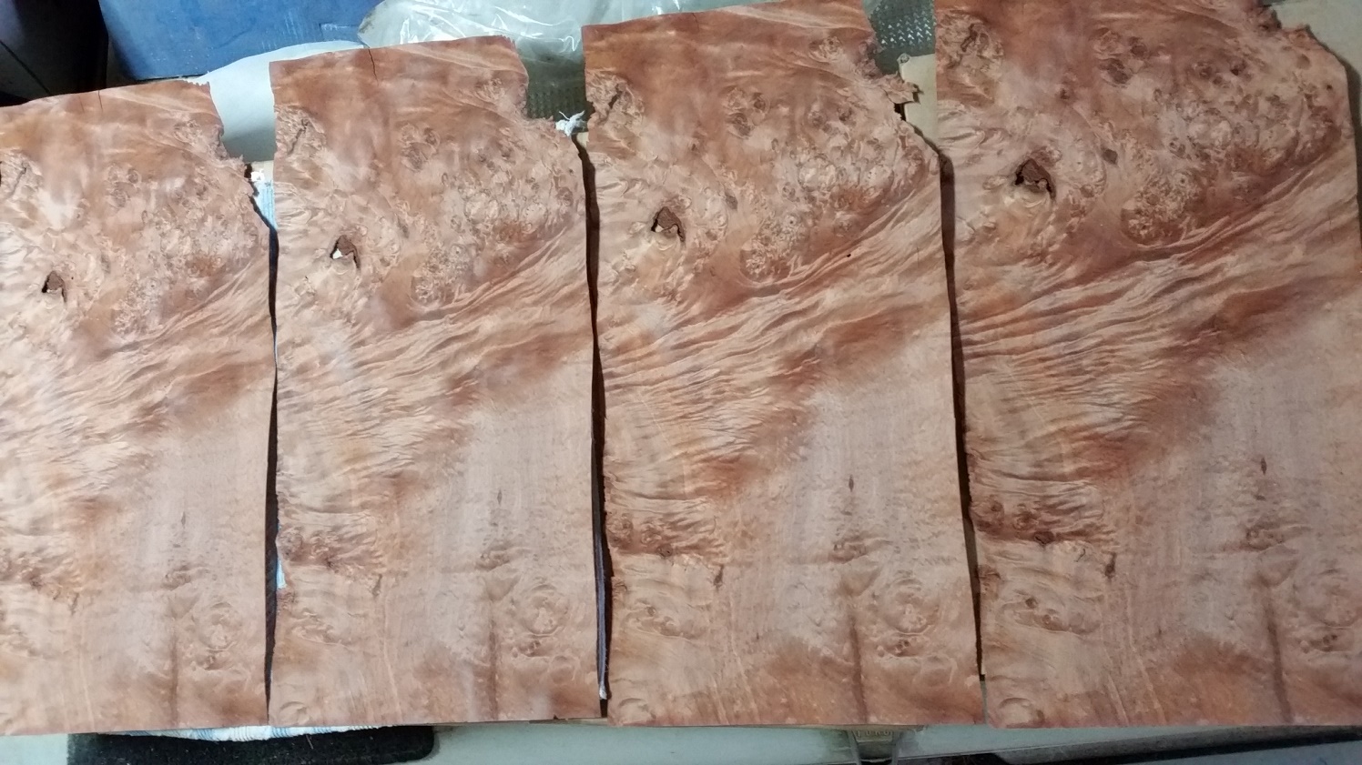

    The body is mahogany, so where are the flames and burls? Right here
    Got these beauties from Australian Premier Veneers. It's Myrtle burl.
    They will be going on the flanks, with the middle section to break them up. Cut out a stencil to work out how to get the most from the sheets. These are my first thoughts but maybe tweaked before cutting anything.

    Not worried about bookmatching the pieces because the centre section breaks it up enough and will try to make it look like the veneers are one big piece with the mahogany added on top.

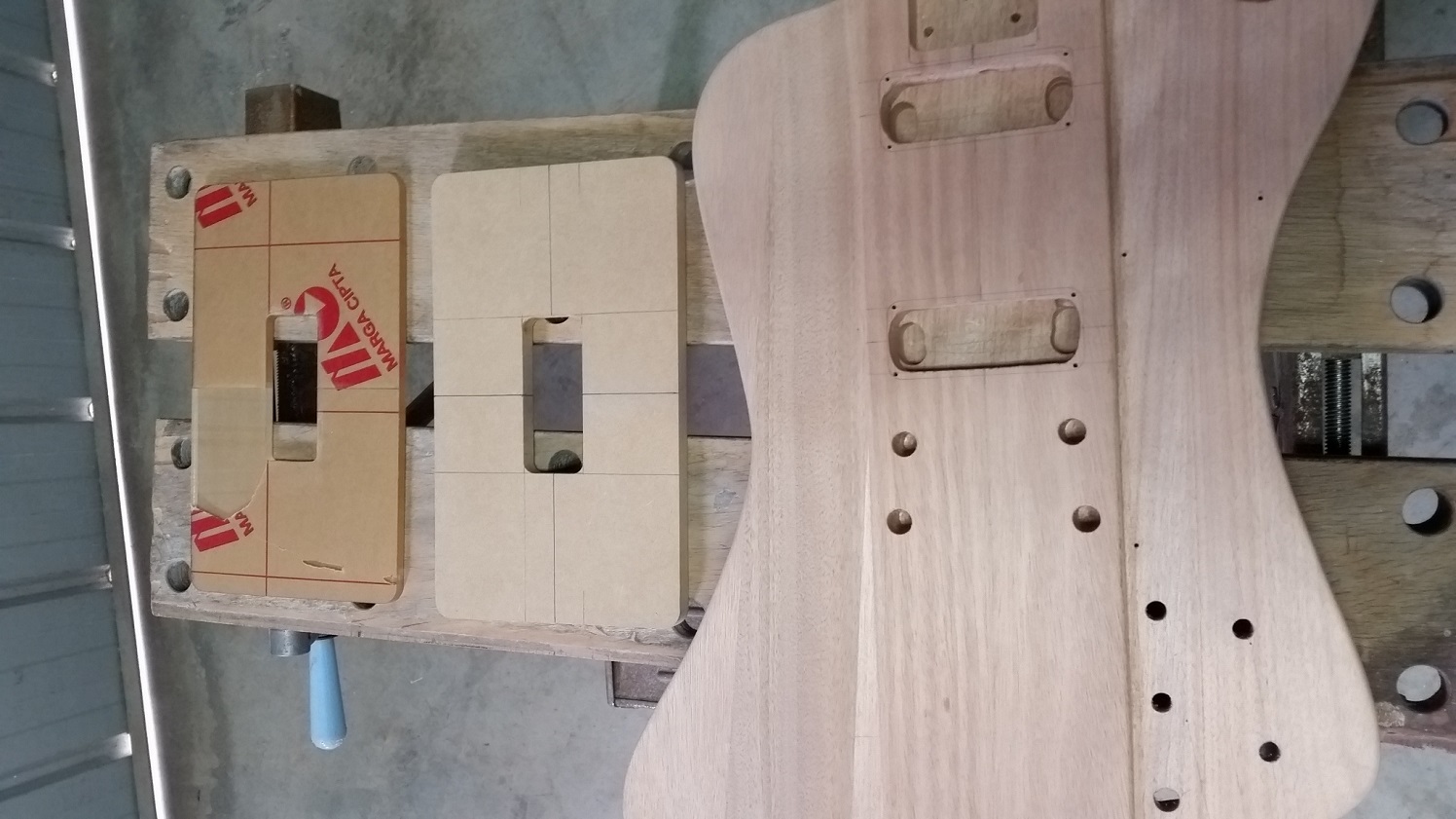

    Also asked Pabs to make a P-90 template for me. He made and posted it really quickly, thanks! He did advise to use it as a master and use it to make another from MDF, which I did. Now I need to check my measurements and get the router out.

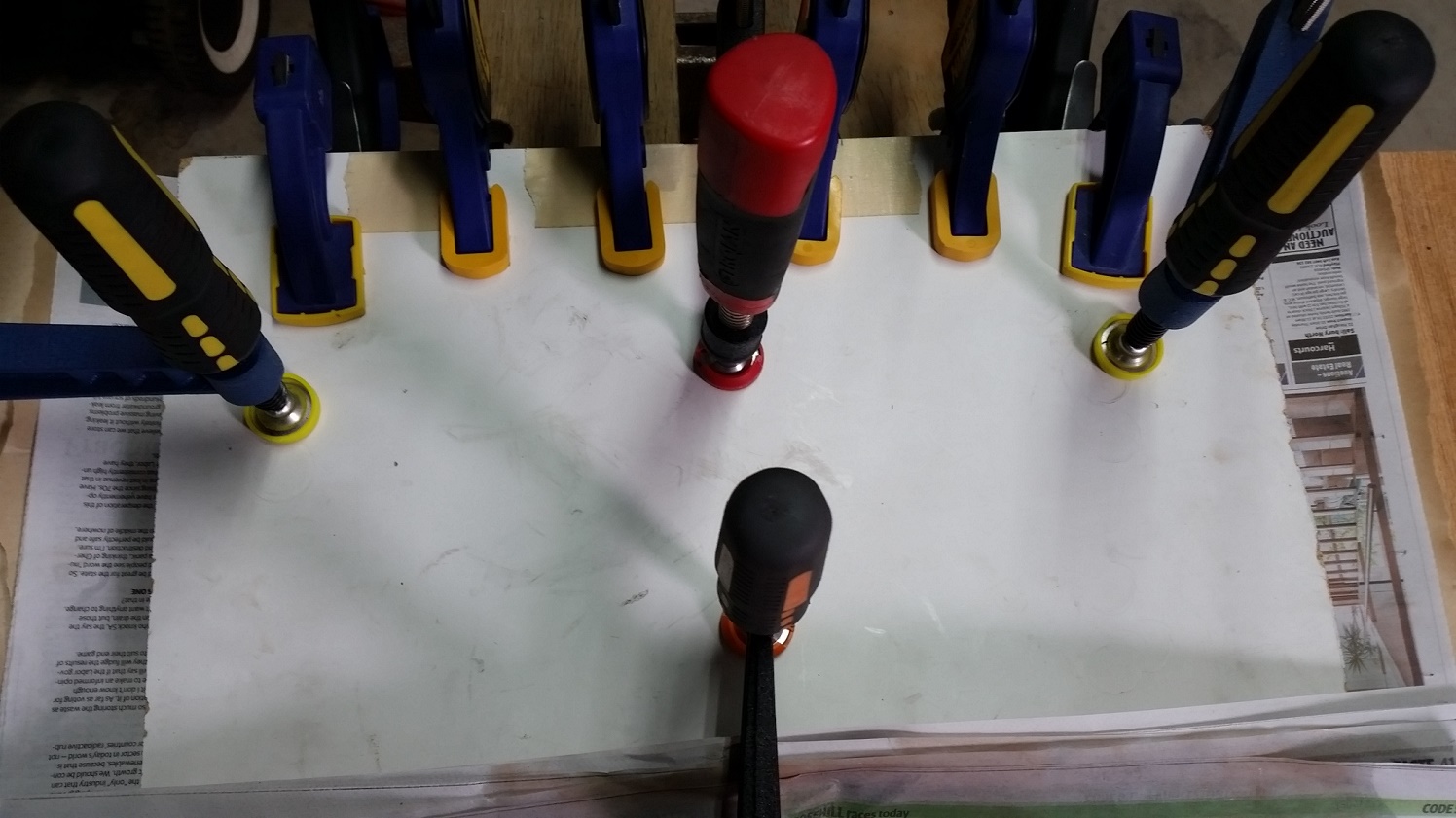

    The pickup cavities have been re-routed as well. The veneer sheets were pretty flat considering they are burled. Even so, still decided to flatten them with veneer softener and clamping. Found a recipe for diy softener on a woodworking forum somewhere on the interwebs, which was 6 parts water, 3 parts alcohol (I used metho) and 1 part glycerine. There are also mixes that use yellow glue as well, but that apparently makes the veneer sticky and can cause problems when applying stain. I don't plan on staining the veneer, but one less problem is one less problem to worry about fixing.
    Sprayed the mixture onto the veneer pieces, waited about ten minutes, then when most of the mix is absorbed, or dripped off, it was time to make a sandwich. I had two pieces of melamine offcuts to use as the upper and lower layer. lay a few sheets of newspaper down, then craft paper ( or any other plain paper) and then the first veneer piece. You want a barrier between the veneer and the newsprint or the ink will end up on the veneer). Then craft paper, newspaper, craft paper, veneer, craft paper, news paper, then upper melamine piece. Then clamps, lots of clamps.
    It's recommended to change the paper every 6 hours, I've changed it a couple times so far, just need to keep doing it until the veneers have dried enough. Still clamped at the moment.
