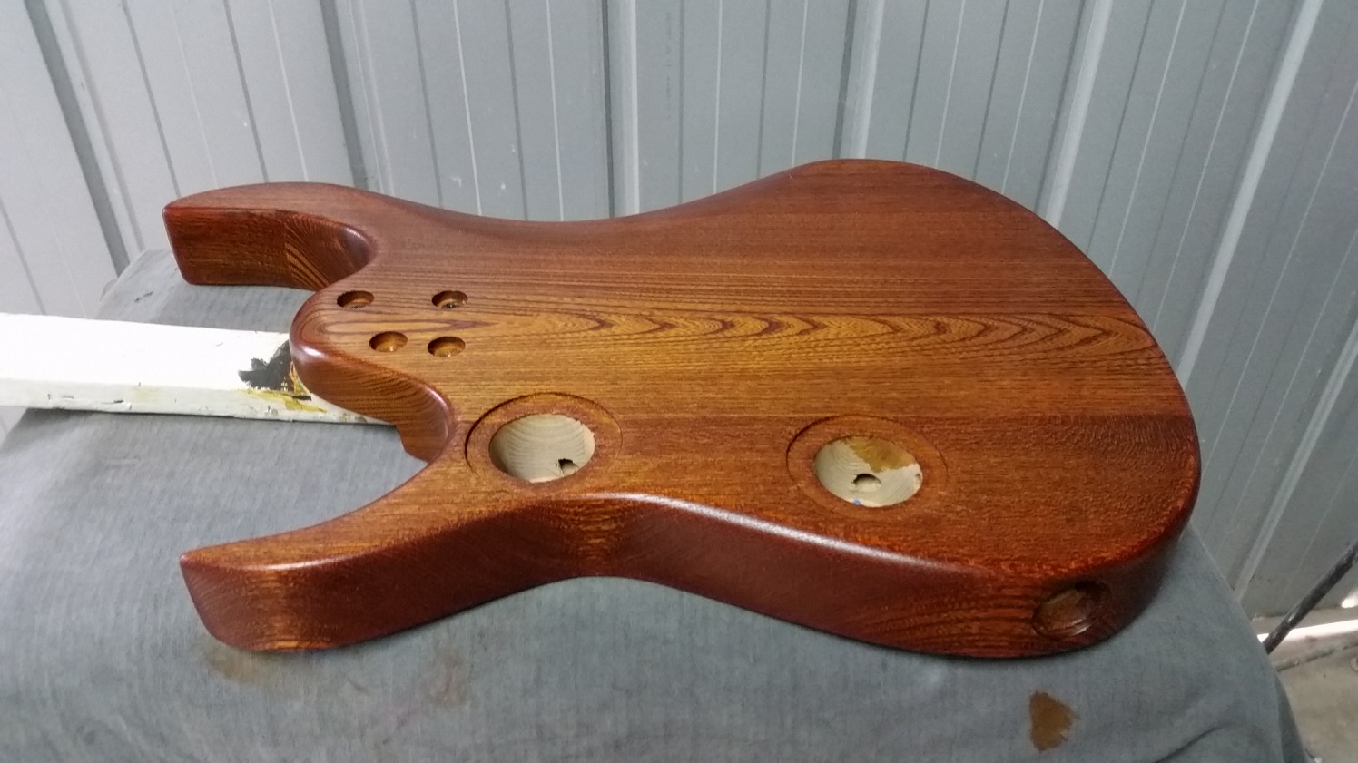

    Grain filled with ebony Timbermate to exaggerate the grain
    Then made up a witches brew of colortone stains. Started with vintage amber, added a touch of medium brown, lemon yellow and a drop of cherry red, reduced with a little metho.
    Two coats of sealer
    Had to put more coats on than intended because the grain fill took on a green tinge. A bit darker than planned, but still looks Ok to me.
