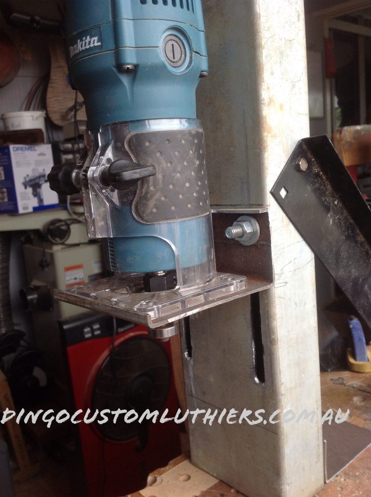

    Why pay $300 plus for a binding jig when you can make one yourself?
    Sure, it ain't pretty but it will do the job

    nice one DB, so the idea is to feed the body into the router and rotate the body ? Is there enough clearance to do the binding channel around cutaways and hard to get places ?
    Why do you need so much height adjustment with your nicely cut slots in the RHS beam ? I assume you drop the router down so it sits at the body height ?

    Yes, you feed the body around and there is enough clearance for cutaways..
    The extra height is for working on Acoustic Guitars.

    If you need to work on acoustics then (as DB will tell you) you will meed to make a 'tray' to support the acoustic guitar body as you will want the top or bottom that you will be routing to be perfectly level so that the router bit cuts evenly and straight throughout the process....also be mindful to follow the grain with the router bit to avoid tear out with an acoustic....also with an electric but its less of an issue!
    no worries DB I thought that was the case for higher body axes/bass's.
    Nice one, must have been hard work cutting the height adjustment slots, is that RHS about 2-3mm thick ?
    aahhh, i see it, cool and simple, thanks

    Was easy as, Woks.
    Drill holes either end and attack with angle grinder!

    Sometimes simple just works. Nice tool DB.
    ah of course DB, the old angle grinder removes steel real quick !
