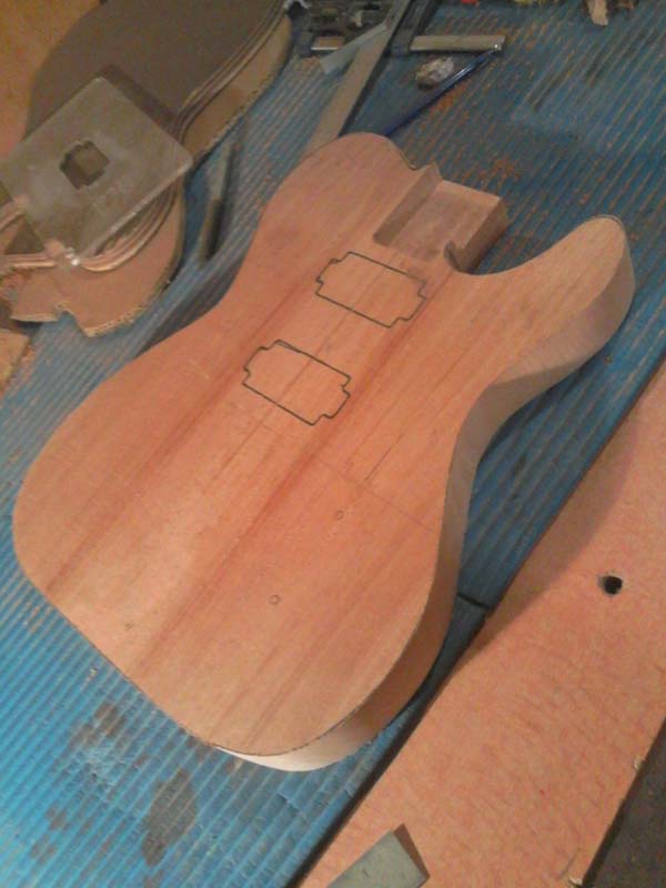

    So I got the rough shape cut out tonight, I haven't got a long flush cut router bit so I'll just have to even out the shape with the sander, a bit slower but should hopefully end up with the same outcome.
    She's a damn heavy hunk of wood, fingers crossed the carve should lighten it up a little bit.
