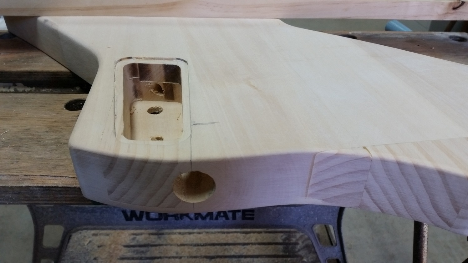

    Filled in the now open end of the control cavity. Being my first attempt at this much modification I left the switch location as a point of reference, also made it easier to plan the new control cavity.
