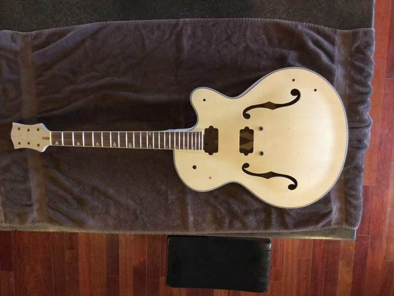

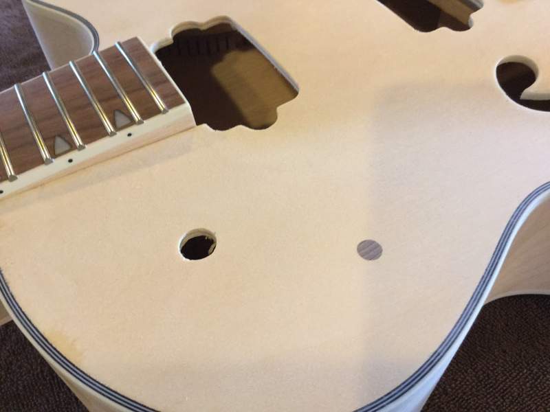

    I was able to get the pics loaded today, so here is the plugs and shaped headstock.
    the kit is beautiful in its raw wood form... Fingers crossed on the painting!
