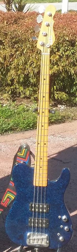

    Ha! I think it's the last bass that Leo Fender designed. As far as I know the only Fender bass that has a body like the Tele guitar. (I am, of course, talking about Fender-designed basses, regardless of the logo on the headstock). It has the same electronics and pickups as the main bass that Leo Fender designed for G&L, the L2000. Aside from the body shape the real difference is the neck profile which is like a Jazz bass, but with a flatter radius. (The L2000 has a similar neck to a Music Man)

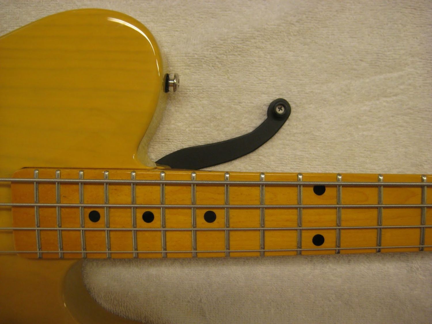

    The electronics in mine have been modded to get more sounds, and the have to have easier access to the battery. Not a great pic but you can also see that it has an aluminum strap extender so that it balances better; without it the bass has quite a bit of neck-dive. It has a "blue swirl" finish that makes it look a bit like a bowling ball. I bought it for the neck, which was the best I had ever put my hands on when I got it. I think the Jazz profile neck I got from PB feels just as good, and I tried to get the finish as close as possible. It's a great bass, it just makes my back twinge after a while. It's not that heavy at about 4.6 KG. My interest in light basses says more about my back than about the basses

    Very Nice. I have also never seen or heard of a "strap extender" to stop nose dive - (I lead a sheltered life!). Is yours attached to the neck plate?

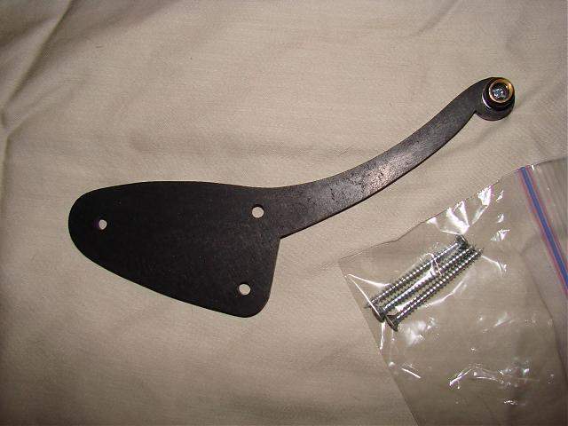

    These were sold by a guy who was a huge fan of ASAT basses. He offered them to folks who sent him an inquiry at Talkbass or at the G&L bass forum (https://www.bassesbyleo.com/forum/index.php). I don't know if he's around anymore. He milled them out of .25" aluminum, anodized them black and included three* slightly longer neck screws.

    I am not sure you can get them anymore. I think the guy who made them stopped. I am sure there are people with the skills to build them on the forum though ;-)
    Steinberger makes something similar. When I have taken the bass out, the Tele body is always an eye catcher, but no one seems to notice the strap extender. T-Birds, LPs and other basses with a short upper bouts that are prone to neck dive might benefit from something like it.
    *Old G&Ls have three bolt neck plates.
