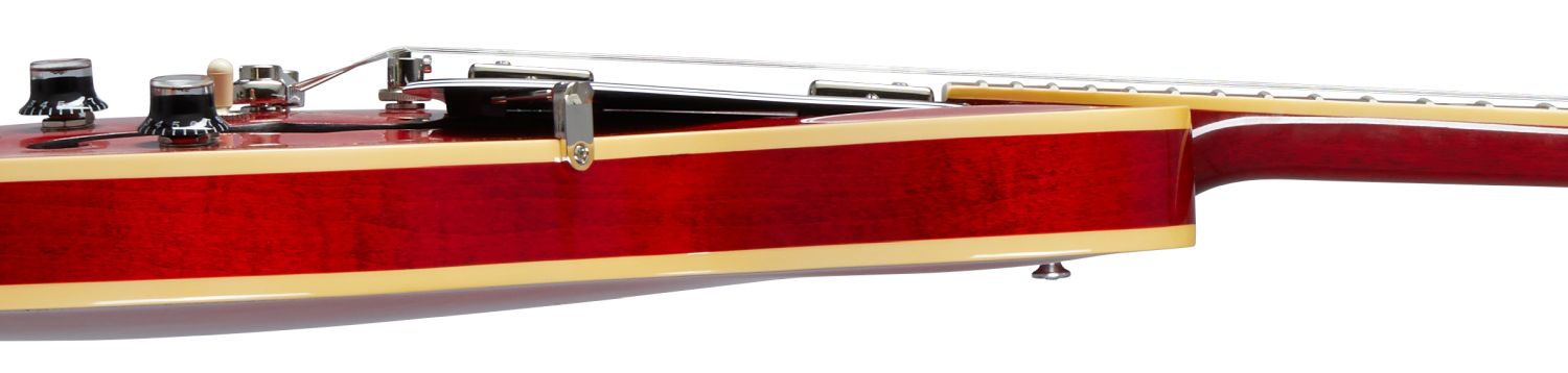

    The neck angle pretty much exists to to accommodate the bridge. The Gibson Bridge is pretty tall, so quite a bit of neck angle.
    Fender bridges are pretty low, so not much angle, if any at all, is necessary, so they are pretty flat.
    So, if your neck angle won't accommodate your bridge, you need to change either the neck angle or the bridge. You can change the angle of the neck, but it's not simple and easy.
