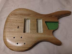

    However - I think I'm close to the final finish on my IB-4 body. 14 coats of TruOil, sanded to decreasing grits throughout. Final coat was a wet sand with 2000 grit, which has left a nice 'just off gloss' finish. (The burn on the rear (done when I had to modify the pocket for the jack so that the nut could be fitted with a router) will be covered by the rear plate. Just need approval from the customer (my daughter) early next month...

    Let's try the pics again after Simon's advice....
