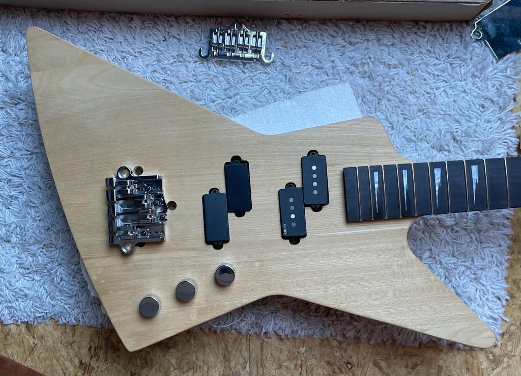

    The holes for the bridge seem to be closer to the neck than I expected. When checking the scale lengt I can only reach the stated scale Length of 846 mm if I put the bridge into the longest possible position...
    I am not experienced with advanced woodwork, so I hope I can avoid filling and re-drilling the holes for the bridge... eventhough they seem to be slightly tilted as well (not the way as explained in the manual but the low strings being slightly closer to the neck.
    I guess this might be due to my customizations (the cavities for pickups are changed to P-style pickups and the control-cavity is slightly tilted).
    The measure between inner nut and middle of 12th fret is 431 mm roughly as expected.
    Are there any tricks to solve this issue?
    Can I simply pull out the neck a few millimeters from the neck pocket without losing stability?
    How manny additional mm will I need in scale length especially if I intend to use a low B string?

    Judging by the pics, it may not be as bad as you thought, but the bridge does look a little close to the neck. I am not sure where a low B string would be, but my low E intonated at about 871mm on a four string bass with the G at 862. If the bridge were placed properly the G string saddle should be at 862 with the lock-bolt in the first or second hole. The G saddle does not need to be all the way forward, but you want a good amount of adjustment.
    You can adjust the neck placement. You would need to move it quite a bit "north." Maybe 12mm or more. Is this a glue in neck or a bolt on? Do you have any overhang on the fretboard? If the fretboard will hide the gap It should be doable. You may want to fill the gap with strips of wood veneer if it's a glue in neck. If it's a bolt on that would not be as important for stability.
    fender3x: The Explorer basses are bolt on neck. Incorrect bridge hole placement seems to a common theme on most of the Exp builds I've seen here. On mine they were too close together. The other common complaint is the bridge is too high.

    There are picures attached with two different "spacers", one 9 mm one 16 mm to check how it would look like

    The neck pocket would allow something as 12 mm displacement without the need of changing any holes.

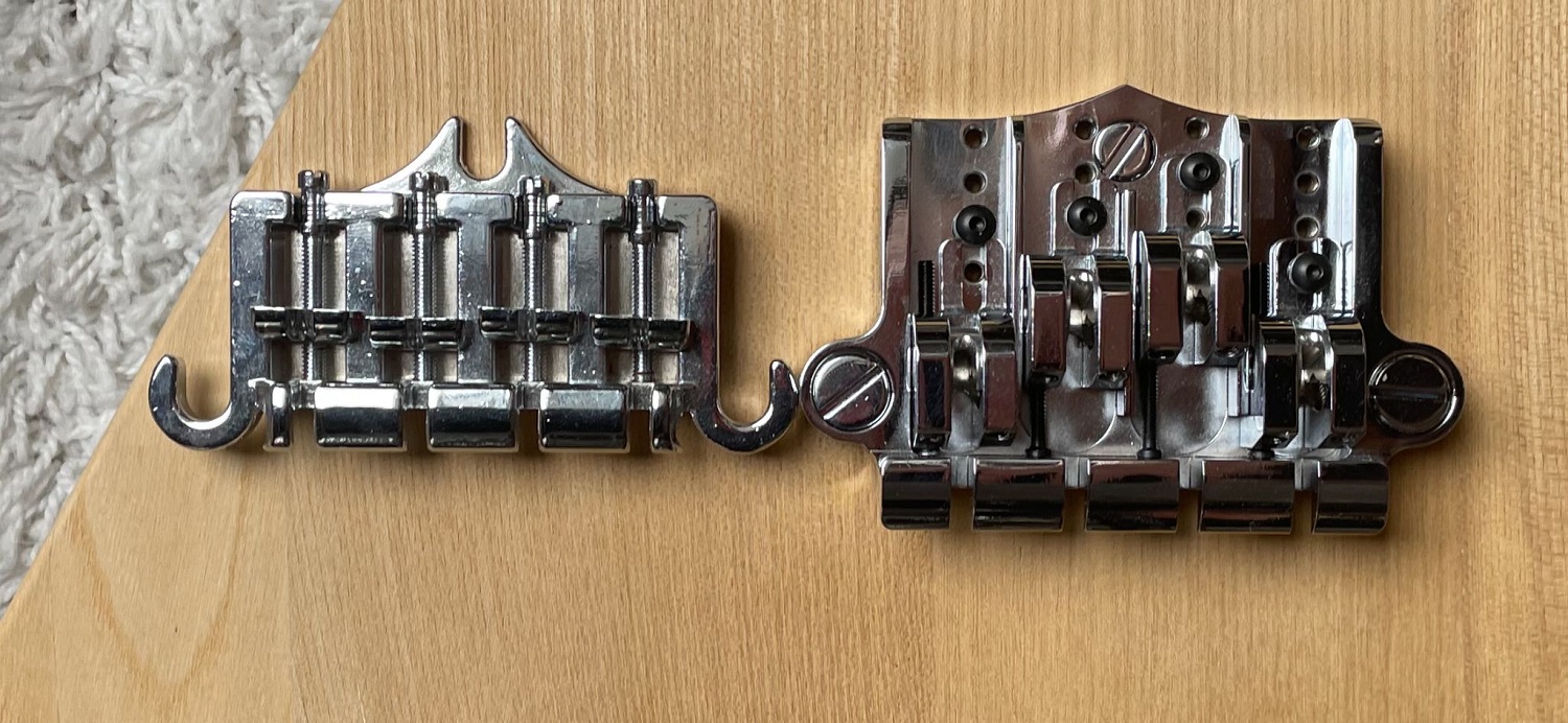

    Indeed, the bridge is not the one delivered with the kit but a Babicz one which was supposed/suggested as a replacement with easier adjustment options. It was also supposed to make slightly lower action possible - which is not obvious by only looking at it for me.
    I crosschecked with the one delivered and indeed this would give a few more mm for adjustment of the scale, but I guess not enough for the low B.
    See image with both bridges. I read not so nice reviews on the original one...

    That said, if it were me, I would probably move the bridge. You want to string the bass with very low strings. So, if you had a G string you'd want it to intonate at 862. For a low B you'd want it to go back 1.5 cm or an mm or two more. The Babicz has tons of travel so why not have it?
    The only disadvantage to moving the bridge is that you need some way of stabilizing your drill so that you make the hole exactly perpendicular to the body. Also you lose access to, maybe, one fret.
    There are a couple of potential advantages to moving the bridge. You can position the bridge to get the maximum travel that you might want from the saddles. Since the neck won't extend as far, you may have slightly less neck dive.
    One possibility that also occurs to me is that you might not have holes to fill if you move the bridge. You did the right thing by getting rid of the kit's 3-point bridge. It's junk. But it came with some ferrules and mounting screws. Once you move the Babicz, you might be able to put in these ferrules and posts..or other large screws. I think they would look like they were part of the bridge, and no one but you would know that they are not ;-) If anyone notices you can tell them that it is drilled for a 34" neck and a 32.25" neck (like the Aria's). Maybe one day you will want to convert it to short scale... ;-)
