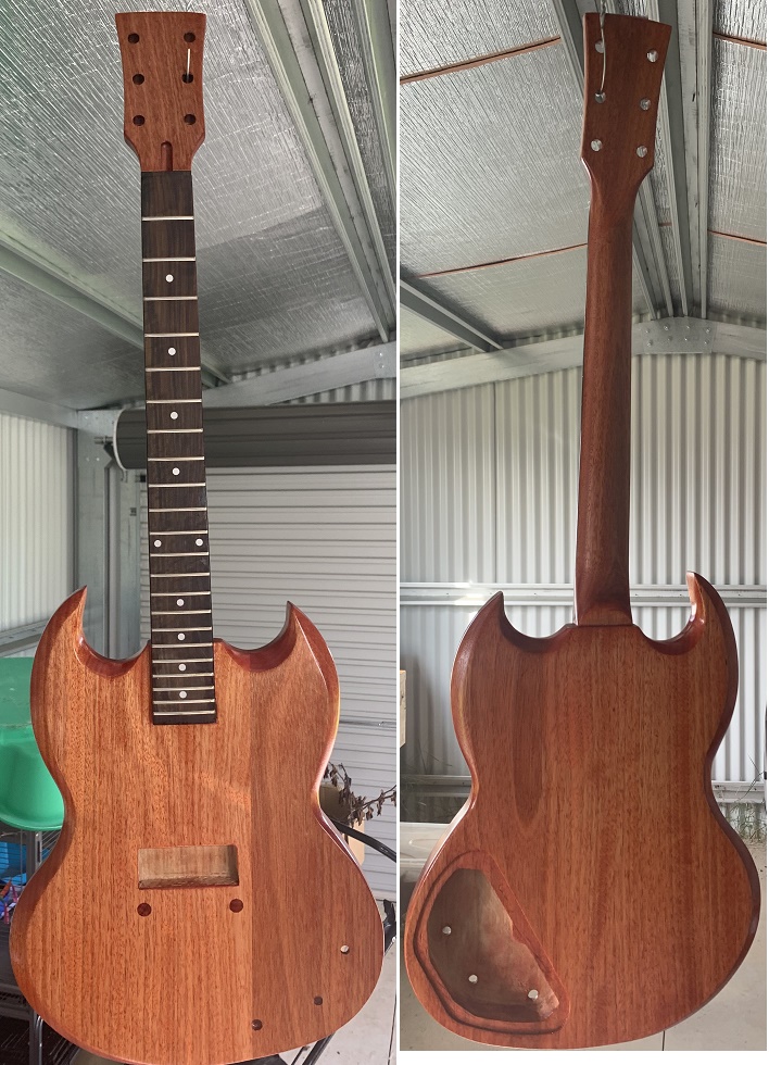

    Started my second build, this time a SG junior kit with the karajini red dingotone finish. I spent some time with a shinto rasp refining the bevels and put on the stain coats - unfortunately the front of the guitar seems to have faded particularly compared with the end-grain. So faded cherry it is
    Had some difficulty with the stain continuing to come off as I moved to the top coat, and based on the feedback from the forum the suggestion was to use Tru-Oil instead. Luckily I still had some from my first build so I've got four coats on the body, and two on the neck (the neck already had two coats of the dingotone neck finish so I'm not sure I'll need to add more). Plan is to go for a matt to slightly satin finish, so when I'm done adding coats on the body it will be a vigorous rub down with 0000 steel wool, t-shirt and maybe some printer paper. Then a quick buff and polish with dingowax.
    Plan for the hardware, I have:
    Martin Smith handwound p90 pickup
    Kluson keystone tuners
    Kluson wraparound bridge - going for old school non-compensated junior goodness
    2 x 500k CTS pots with orange drop .22uf cap
    Vintage braided wire
    Going for an uncomplicated rock guitar

    Hi geoffro.
    I think this will make a great colour - not sure if I would call it cherry!
    Has the red made a huge difference to the (I think) mahogany? It is hard to tell from the picture. In my LP1-SS build (Mahogany body and neck) I added DT Nullarbor Ochre to the back and sides of the body but that did not make much difference!
    Hi Trevor,
    Yeah initially the Karijini red was very dark cherry coloured - you can really see the difference in the end-grain of the horns. And yes it’s mahogany and there was definitely a difference when I first applied the stain coats.

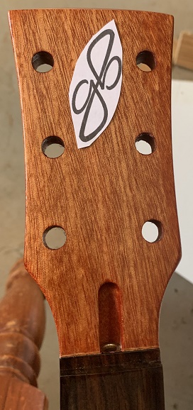

    Testing out headstock logo. Now just waiting on my transfer paper to arrive from the brazilian rainforest...

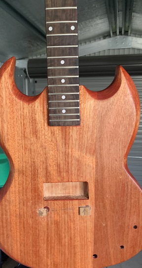

    Well I've been struck, unfortunately not thunderstruck but struck with disaster.
    Man what a tale of woe that I have to tell, I had marked the locations of the new bridge holes, used a straight edge to check that the strings would pass over the pickup poles, yet somehow I managed to completely screw it up so badly the low E string was off the fretboard by the 17th fret in the process managing to put a few dings in my lovely finish.
    To make matters worse, trying to drill the earth hole to the new hole I popped the screw out through the top. And then managed to snap the drill bit in the hole and can't get it out I had also seen people of the 'tube use a small bolt to help pop out the bridge bushing, but it apparently wasn't big enough so I ended up with it getting stuck down there. I managed to pop them using a claw hammer and lots of padding on the body and bridge pin.
    So I've plugged the holes up, trying this time to use long grain instead of end-grain (from the dowel) to see if I can make the plugs disappear better! Oh and I also managed to chip some of the plug off the bass side when flattening it, so have tried to make a sawdust and PVA filler.
    Wall meet my forehead, multiple times with some force!
    Plan is sand back the front, reapply the dingotone stain coat to see if I can hide the patches, possibly even covering the existing dowel plugs with a small long grain plug. And then I've been toying with the idea of a home made finish similar to tru oil (1/3 poly, 1/3 boiled linseed, 1/3 metho) or maybe just buy another small bottle of tru-oil.

    Ouch indeed!
    I feel for you. Been there quite a few times.
    There's always the solid colour option if all else fails.
    With the bridge at an angle, the strings will come off the top of it further to the right (looking at it as per the photo above) than the string holes in the bridge, so you really need to check using string from the bridge up to the headstock, and then mark the bridge position using the mounting screw cutouts.
