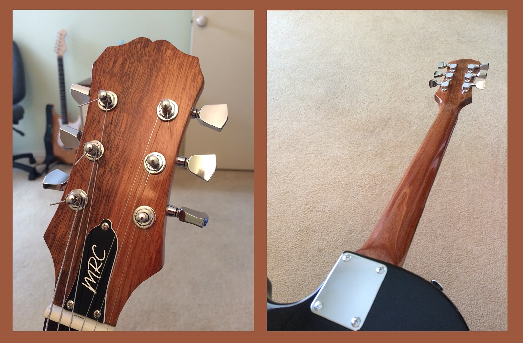

    The neck below is Mahogany with 24+ coats of Tru Oil, wet sanded and polished Micro-Gloss. It feels absolutely great in the hand, not grippy at all:
    (Open to zoom) (note: neither are PBG kits)
Name:	Mahog TOil 2.jpg
