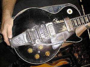

    If it's this incarnation of Old Black:
    Then the Alnico V Artec will be the closest you'll get at low cost.
