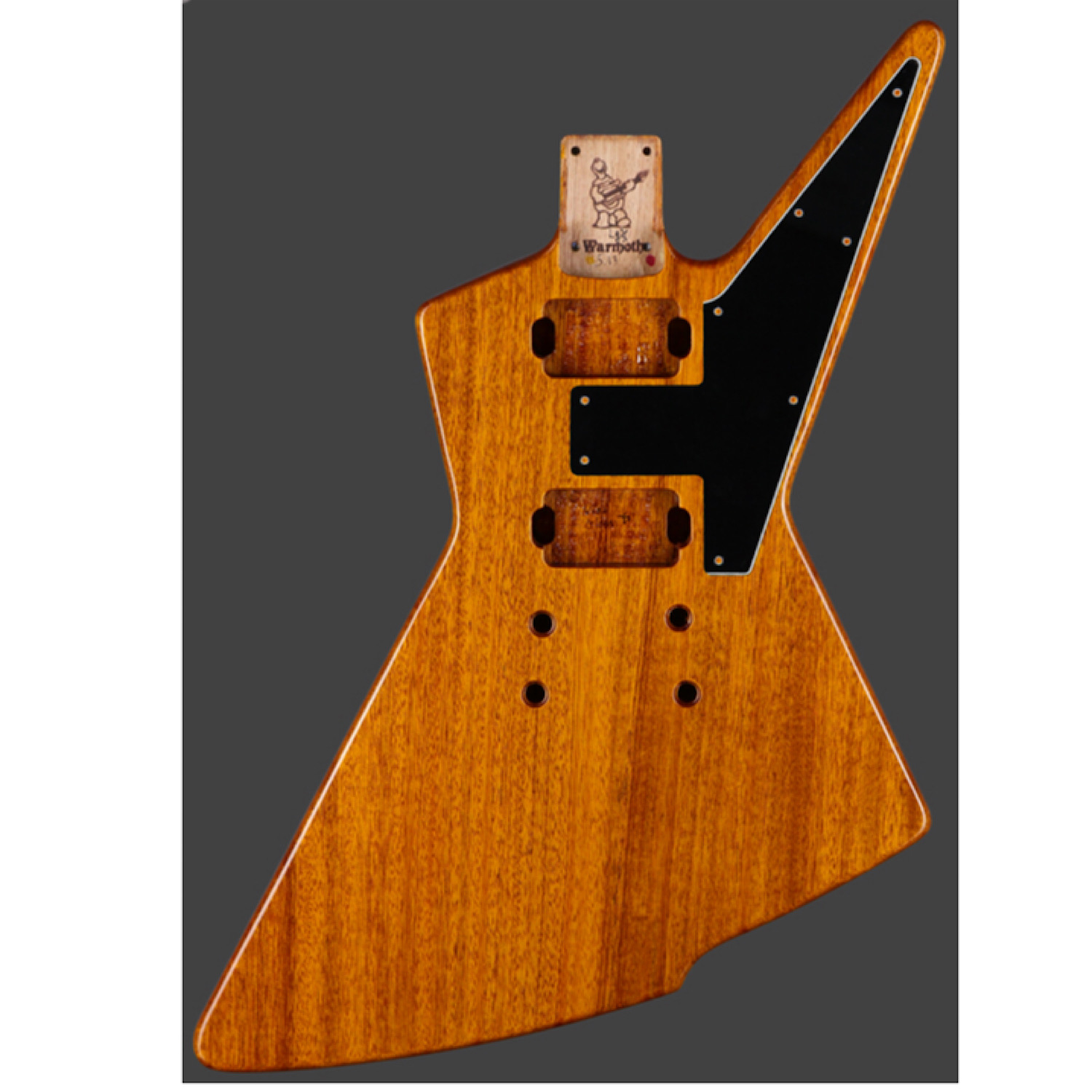

    No second thoughts. For full 24 fret access, you could even take more off. You’re building the guitar I almost ordered about a year ago. I’ve been wrestling with how to cut the body for access as well.
    It looks like the Warmoth Nomad body cut the horn for upper fret access and then cut an equal amount from the bottom to make it look balanced. I was going to do something like that.
