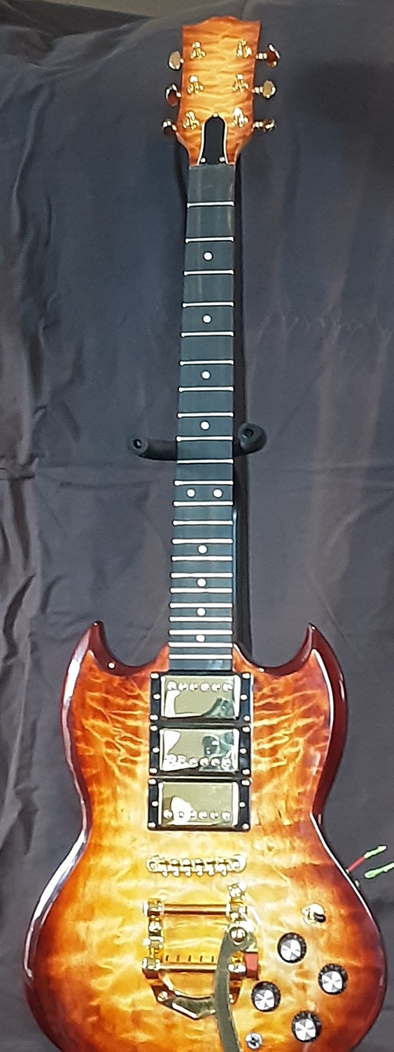

    First build-Head Stock Click image for larger version.
Name:	Head Stock-1_resized.jpg
    Its been a while.
    Left a mark on the back of the neck joint gluing the neck last night. clear coat seems to be a bit soft still.
    Need to sort out the wiring for the 3 pickups, proving to be a bit of a pain with the parts supplied. Anyone have any ideas of how to best wire this guitar?
Name:	SG paintwork_1_Resize.jpg
ID:	37053Click image for larger version.
Name:	SG paintwork_2_resized.jpg
    Wow! That's lovely grain on that headstock.
    That'll feature nicely with a nice gloss clear coat!
    And work on the body too!
    There's currently a thin line of unstained veneer by the nut on the headstock. I'd use a small paintbrush and get in there and touch it up, as it will become very annoying over time if you leave it.
Name:	InkedHead Stock-1_resized_LI.jpg
    Sorry for not getting back sooner. Things have been really hectic lately, as John Lennon said, "Lifes what happens when you're not looking".
    Anyway, that line will be covered by the nut as the nut has been removed. Thanks for the comments.
    There’s no simple answer as you’ve got two basic wiring schemes to consider. See this thread. https://www.buildyourownguitar.com.a...ad.php?t=10660
    Thanks. It seems that in a majority of instances when dealing with a 3 pickups, 3 way toggle, two volume and two tone controls is to convert a tone control into a third volume control and convert the tone control into a master without getting into fancy wiring and switches.
    Ill try this first and see how it goes.
