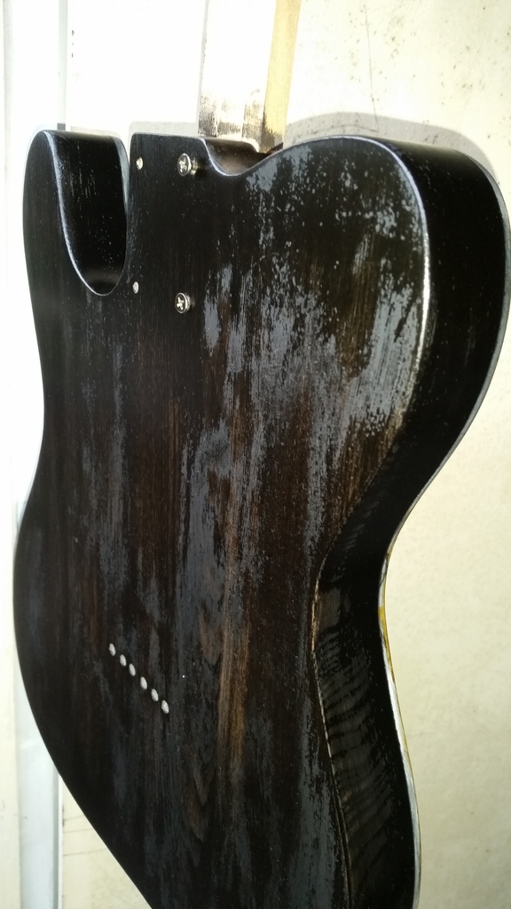

    I had done two applications of intensifier to the Dog and the BS was very patchy so I gave the back and sides a good sand with 1000 yesterday and applied a 3rd intensifier and its come up a treat.
    Also put the first coat of clear DT neck finish on, a bit of a surprise when I poured it out and saw a faint purple colour
  10. #169
    2,810
    The BS has gone patchy again so not sure where to next.
    See the Black Stump Weirdness thread in the Dingotone sub forum for a bit more info

    Just out of interest, what sort of temp and humidity have been around during application and drying? Any large changes in conditions?
