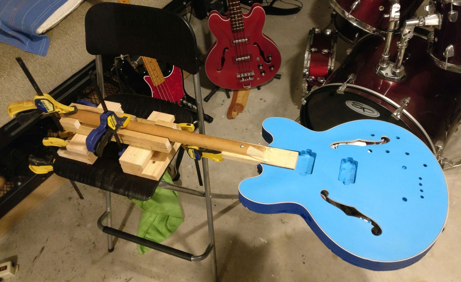

    Someone posted a pic of a rack they had built for finishing their quitar body. I hope whoever did it, will post here and get some credit ;-) The rack allowed him to turn the body as he was painting. A great idea.
    I recently realized that I was going to need something like this because I am using a brush-on clear coat. Much easier to do if I have both hands free, and if I can turn the body to catch drips and do both sides.
    Unlike my predecessor who built a floor stand. I built this to attach to a tall, stable chair that I have in my garage. You could also make this to attach to a sawhorse or workbench.
    It's a very simple rack. Here's a pic of it clamped to a chair.

    I attached the guitar body to a meter-long wooden cylinder that was left over from re-modeling a closet. I made the central channel in on the rack.
    [/ATTACH]Click image for larger version.

    To rotate the guitar body, you just need to loosen the two upper clamps that hold the cylinder in the central track of the rack. Works like a charm.
    BTW, if the rack looks rough that's because it is constructed primarily of boards my kids broke in Taekwondo. They have broken so many over the years, I have had to find creative things to do with them...

    I hope that chair is heavy enough to counter the body weight. I'd hate to see a post about a freshly painted body crashing to the ground!
    The chair may look flimsy in the pic, but is actually very stable, and the body is pretty light. If it were heavier I might add cinder block but I don't think it's necessary for this build.
