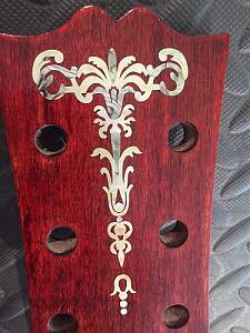

    Thanks heaps Wokks. I must say I was a bit shocked to see that angle on the fretboard as I didn't notice it when the plastic nut was on. Mind you I didn't take much notice as I always knew that thing was going to be whacked off.
    In brighter news I received my front and back headstock decals from Japan! Yaaaay

    headstock decals look cool Andy, I've never had a back HS decal I think it's a great idea.
