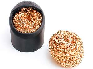

    Forget cheap nasty soldering irons, if you intend to do more, buy a good one.
    You can either use a wet sponge or a brass wool tip cleaner, i use both, i also tap it on cardboard sometimes.
    I also keep a small desk fan going.
