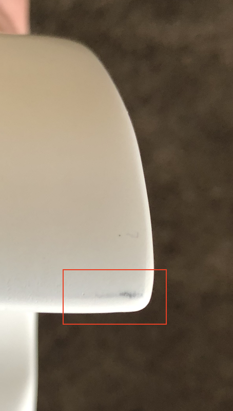

    Its looking tremendous mate, you should be proud. Going to look killer when all done! Where is the spot your talking about located on the guitar? I can't see it in the bigger pictures. Depending on where it is you could try a spot touch up. Mask around it, sand back and start the process again in just that one tiny area. Did you get down to bare wood or primer?

    I've upload a new pick showing a red box around the sand through. It's showing the primer so not to the bare wood. Its right where the strap pin would go.

  3. #63
    I'd mask around it as has been said already, then spray white and then some clear. After a couple of coats of clear. I'd widen up the unmasked area and add more clear, as you'll need to feather the finish in with the rest.
    It is very easy to sand through around the edges - you don't realise how much extra pressure you can apply. So always best to give edges some extra coats.
    If you are spraying nitro, then it will happily go on to a gloss surface. But any other finish probably needs a light sanding to give the new coats something to grip on to.
  4. #64
    Thanks Simon. I was hoping I could tape off and touch up so good to get that advice. I’m actually using acrylic clear so will rough up a little to get it to stick. I was in a panic but feel a little better now.
  5. #65
    Acrylic blends really easily so you won't have to worry about roughing it much. As long as you are spraying like onto like it'll be fine. Try to avoid spraying right up to the taped edge, as you can create lines and bumps, try and blend to where you have taped. Then when its nice and hard you can cut it back. I'll often tape up the hard edges when polishing and cutting and leave them till last. They usually end up getting buffed pretty well inadvertently, so good idea to protect them while you are getting the flat bits nice and shiny.
  6. #66
    Thanks Sonic, just starting now so will take all these tips and see how I go. Luckily it’s a small area so hopefully easy to rectify. Hard to blend using spray can though. Learning a lot from this build.
    I'll say. i.e. Cabot's Exterior gloss and SCA acrylic clear gloss do not get on.

  8. #68
    Quote Originally Posted by a_novice View Post
    Use height and or distance to feather
  9. #69
    Luckily i'm using just SCA products so should all be good. Will try the heigh and distance trick and see how i go. I guess it gives me time to finish last few coats of clear on the headstock while i'm waiting for tru oil order to arrive.
