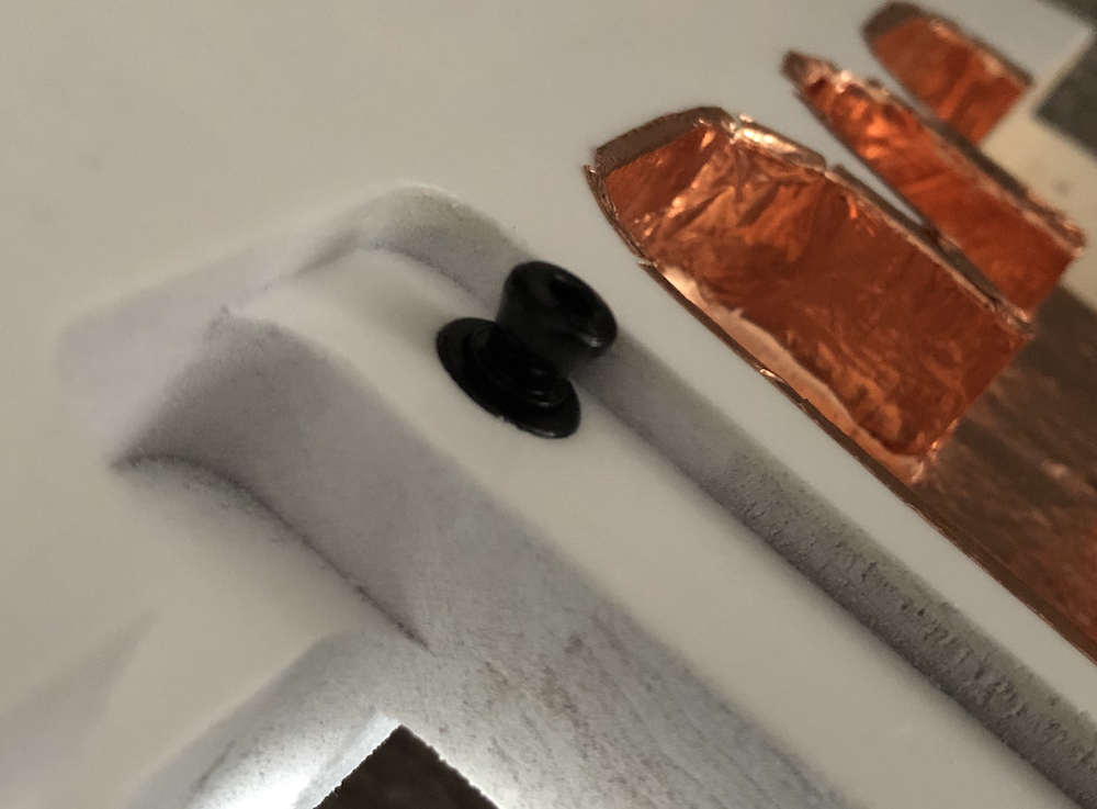

    Hey Novice, don't feel alone with your sand-thru...was being super careful and this just happened tonight flattening some paint not clear
    Black was my second choice, lol.

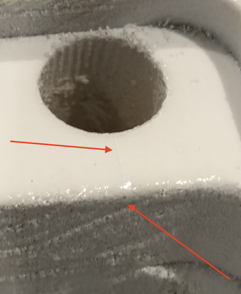

    Advice needed on crack! Started to tap in the first bridge peg and noticed a hairline crack appear across the grain! So I stopped, pulled the peg out and took the attached pic. You can see a hairline on the top bit it only goes down about 1mm so managed to stop before i did anything too major.
    I did check the hole size by putting the peg in by hand and it seemed tight but started to go in so thought it would be ok to tap in, obviously not.
    I was thinking of sanding a little just to make the hole slightly larger...but how to handle the crack and stop it from getting worse, especially if I'm bending the bridge back and forth when playing over time??
    I also have a round file that i can use just to get a little extra room.
    Thoughts?

    For the crack, get some thin super glue and what they call a whip tail, it’s like a thin piece of plastic flexible rod that goes in the end.
    you can use that to wick some of the super glue into the crack to stabilise it.
    I’d be really careful about widening the hole, I’d be more inclined to get some wax and lubricate the anchor before putting it in.
    Give the glue overnight to set and cure before you do it though.
    Thanks for the advice FW, I hadn’t thought of that but will give that a go.
    Also put the post receivers in the freezer for 20mins before tapping them in. Plus some wax and they should go in easily. Then the will warm up, expand and seat themselves.
    Thanks SM. I definitely wouldn’t have thought of that! Just hope the hairline crack doesn’t worsen over time with all those dive bombs in hanging out to do with the FR!
    UPDATE: I tried one of the pegs in the freezer and it went in! Tried without the wax first to see if it would work and i was able to put in by hand for half of it and tapped in lightly for the rest, with no crack (so far). I was looking at the other one and the more i look the more it seems to be a crack in the clear coat rather than the wood, but not 100% sure.
