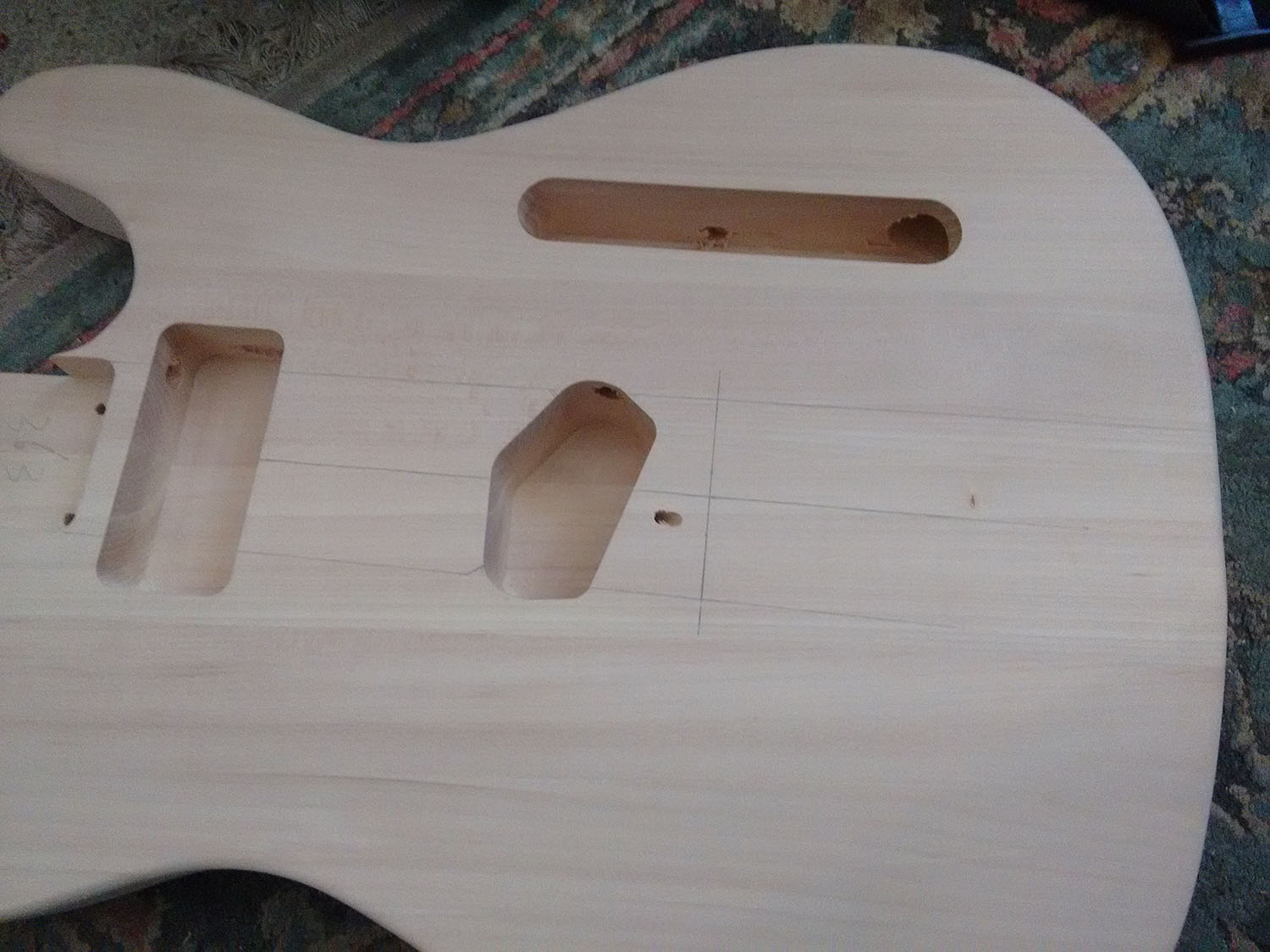

    It's arrived!
    Nothing spectacular this time (cough cough).
    A straightforward work-horse that resembles an iconic scheme.
    cheers, Mark.
    Everything looks to be in good nick.
    Neck isn't what I'd describe as a tight fit, but certainly no gaps.
    I'll be using an original 4 screw Fender bridge plate...any day now.
    Probably be the standard yellow/black colour.
    Not so much into 'relic-ing' but not a glossy finish either.
    Function-over-form, so there's what's called an 'elbow' cut and a 'belly' (more like 'rib cage' for me).
    I'll also be using the non-asymetrical neck plate.
    cheers, Mark.
    Once again going with 'vintage' style tuners.
    Only 8mm so it's out with the dowels again.
    I'll have extra sheets of veneer left after my JM-1 re-finish.
    cheers, Mark.
