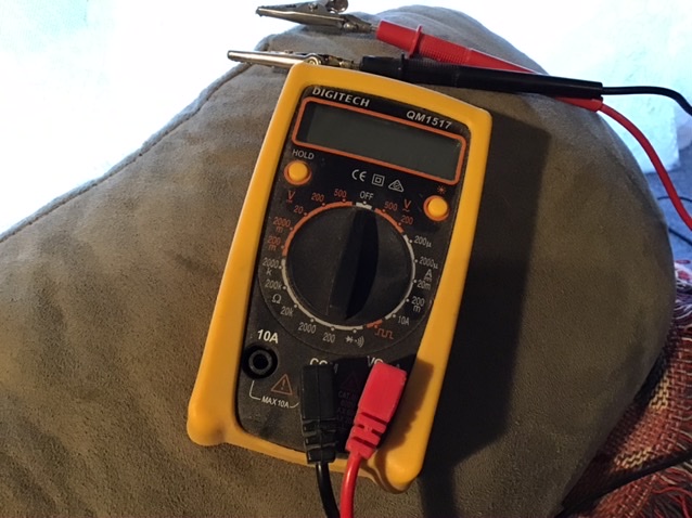

    Post a photo of your multimeter so we can be specific.
    Mostly all you need for guitar electronics is resistance, which will be the section marked Ω (&Omega). There will be a number of ranges against the Ω, usually the next largest than 500K is the right one. A continuity test is also useful.

    This my multimeter.

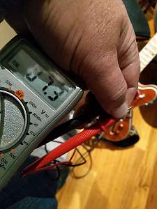

    Here's measuring pickup resistance via a guitar lead. Neck pickup selected, can see my meter set to 20k and probes held to centre tip and sleeve of the cable it's showing 7.2kohm which is roughly right. Even with your tones and volumes set to '10' measuring pickup DCr (direct current resistance) isn't ideal this way because switches and controls and cable can throw the result. Normally you wouldn't hold the probes to the contact like I am with my fingers either. Your body is 30% water so it is slightly conductive - why you can electrocute yourself very easily.

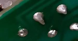

    This is Marshall factory soldering from 1983, all the joints here are serviceable, but the two bottom ones are not perfect, the lead isn't 100% enveloped. They are all smooth shiny blobs

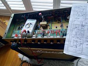

    I have 4, a $10 one in my gear case with tubes and my spare strings etc. Plus a couple of semi serious ones. Just diagnosing a reverb issue with my 4210.

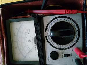

    My best is this 1960s AVO ex-RAAF aircraft mechanic unit I bought for $20 off fleabay It's still dead accurate - from the days planes had tubes
