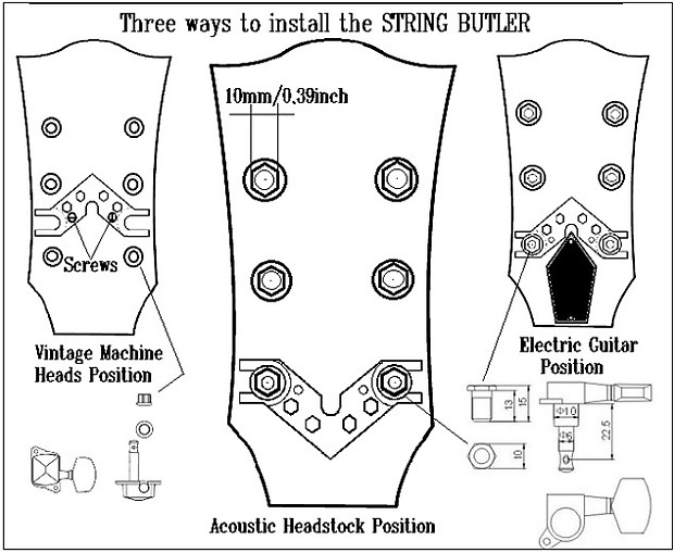

    Enter the String Butler, this is a small plate with 4 roller pins mounted on it, which once mounted on the guitars head stock, changes the string break angle between the nut and the tuners so it is a lot straighter, which stops the string catching in the nut after string bends.
    It seems easy to fit, and can easily be removed.

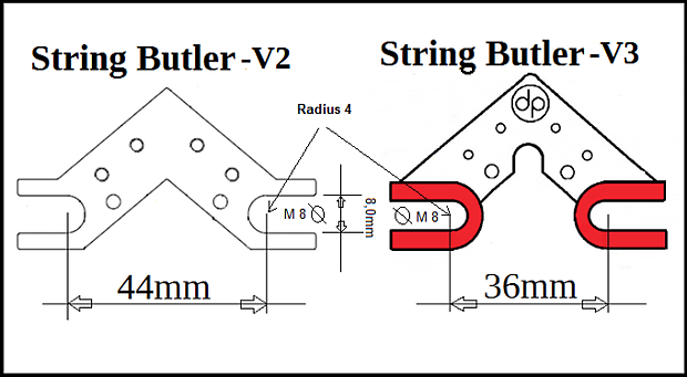

    Below are some tech drawings of the two different types that fit different measuring guitar head stocks.
Name:	string butler tech 2.png

    I reason that since this a DIY guitar forum, it's not unreasonable to think that this problem could be sorted in the construction stage, and without the String Butlers base plate that affixes under the tuners, by simply placing 4 such pinned roller directly on the headstock of a LP or SG built during construction.
    I've given you the Tech drawing above that gives you the dimensions so you can work out where to place the pins.

    A bit of progress with the DIY String Butler like rotating string trees.
    I went to Hobbyco in Sydney's City center on the way home from work the other day, basically to see if I could find two lengths of Brass tubing that one could fit with precision, within the other.
    After measuring my Gibson's, I found that to emulate the strings trees used in the String Butler, they would need to be at a height of 10mm, sans base plate used with the String Butler, as these string trees would be direct mounted.
    The idea is to have a inner diameter Brass tube cut to 10mm height, screwed down to the headstock, but before it is, it has a outer diameter Brass tube surround it, cut to 9mm height, so the inner works as a Axle, and the outer rotates around it, the strings rest against these outer tubes.
    A simple Brass wood screw, with a head large enough to hold both tubes in place will do the job.
    Well I found what I needed very easily.
    Hobbyco- stock numbers are with #
    https://hobbyco.com.au/
    Both lengths of Brass tubing came in 36" lengths [which is enough to make at least 20 sets of 4 string trees ]
    Stock #1148 7/32 x .014 Brass tube -use this as the inner axle- cost was AUS $9.95
    Stock #1149 1/4 x .014 Brass tube - use this as the outer casing which the string will rest against - cost was AU $11.50
