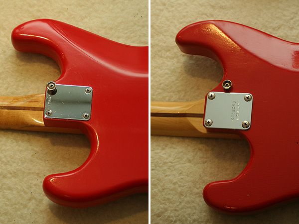

    I have seen this a lot on bolt on LP/SG guitars...
    ...although this seems to be on a Stratosomethingorother. I have also seen it like this...
    ...this last one would be relatively easy on mine because I used bolts and ferrules rather than a neck plate.

    I went with something like the bottom shot on my EX-5 as it is such a long and heavy neck diver. The regular strap button spot was no good and had to drill one through same spot on the bolt-on neck plate and it made a huge difference. Still wants to dive a bit but nowhere near as much as before.
