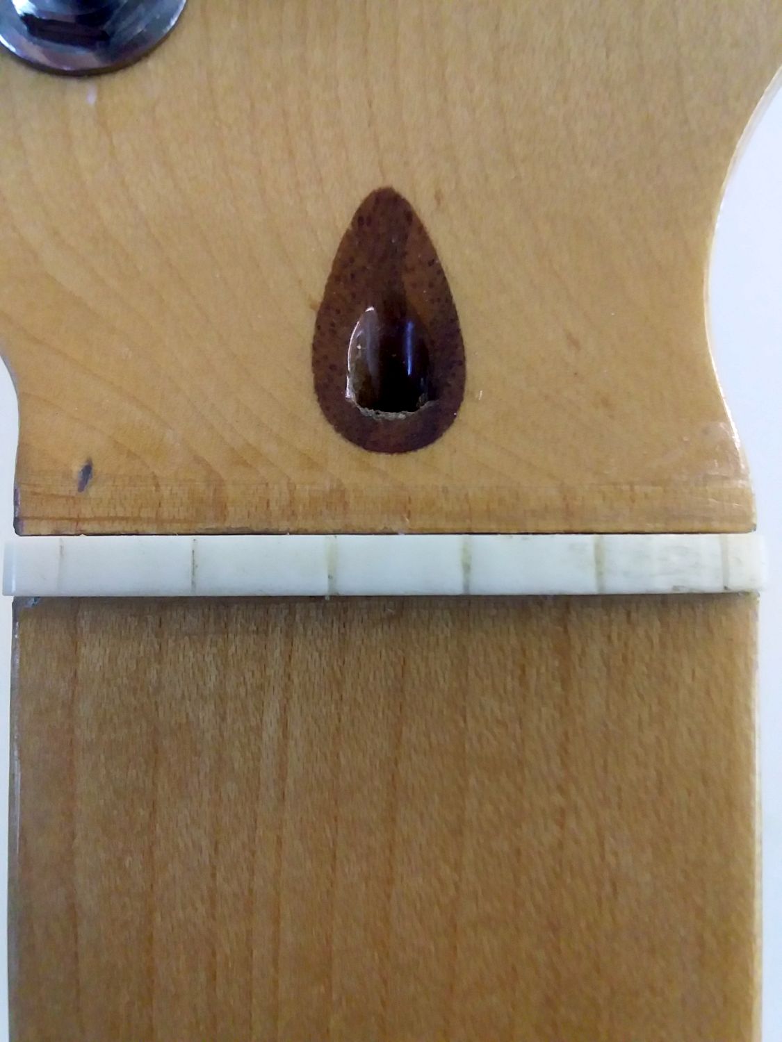

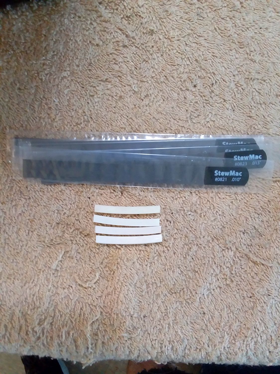

    Some more stuff from Stewmac just got delivered today, a new set of nut-slotting files in 42-10 gauge, and four spare un-slotted and bleached white bone nut blanks, I bought them so I could finish the job of installing a new bone nut on my Fender USA Strat,I've already got a pre-slotted bone nut glued in with some PVA glue and the four spare bone nut blanks I ordered are just in case I stuff-it-up, that gives me four more chances to get it right or stuff-it-up....whichever comes first.
    Here's a pic of the glued in pre-slotted bone nut:

    And here's all the stuff I ordered from Stewmac:
Name:	Stuff From Stewmac_resized.jpg

    Just in case things do go a bit pear-shaped while filing the slots in the pre-slotted bone nut, I'll first use it as a guide to mark the slot positions on all four of the other bone nut blanks....before I go filing the slots to the correct depth, that is, I made myself a special half-round pencil so I can mark how deep the slots need to be filed, all you need to do is lay it on top of the fretboard with the flat side down and the point of the pencil touching the front-face of the nut blank, then draw a line to indicate the depth, I got this tip from a local Darwin Luthier.
    Note to self: Must buy a tool from Stewmac so I can accurately mark the positions of the slots on the bone nut blanks.

    Well....it took me a couple of tries, not to mention some not-so-nice verbally spoken words, but I finally managed to get a new bone nut installed on my Fender USA Strat, only had to tweak the nut-slot depths for three of the nut slots and the 1st fret action is all good and on spec according to what my Stewmac guitar repair handbook says, .020 inch (sorry about the imperial measurement).
Name:	New Bone Nut_resized.jpg
    I used the .020 inch feeler gauge from my set of automotive feeler gauges to check the 1st fret action for all the strings, each one was just touching the .020 feeler gauge, so I'm happy with it, I sanded and filed-down the top of the bone nut so that it was more or less level with the strings, each string seems to ring-out cleanly when played open, no dreaded sitar-buzzing, so I think I got lucky, the nut-slotting file for the A-string seemed a bit under-sized for it, but I managed to get the A-string to fit properly without binding.
