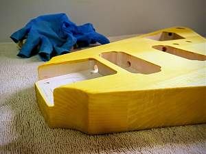

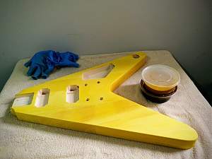

Being in lock-down i'm having trouble buying stain online.. So I decided I would try some handmade stain.. I'm going to attempt a tobacco burst, with Turmeric and instant coffee
That's about it for today. I've sanded her down, check neck pocket, and started with the first coat of yellow (turmeric). I might add another coat of base turmeric I made up, and then maybe do the middle out with coffee.. then keep doing the outer edges with just coffee.

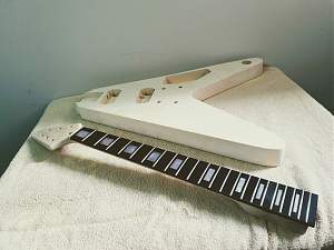

I also found an old ebony stain pen, and took to the fretboard top darken it.. Looks a bit trashy in the photo, but once I stain and oil the neck, it should clean up nice.
Heres some pics.. Until next time
