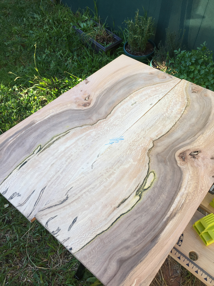

    In other news, I ordered this great piece of spalted Plane tree online a few days ago and it arrived yesterday.
Name:	spalted plane tree 4.jpg
    Now I just need to order the kit!

    Good advice FW. Luckily the hard tail bridge appeals to me most aesthetically, and while I'm reasonably confident I could drill the holes for the Schaller, it would also stress me out.

    Nice looking piece of veneer you have there.
    One thing you would need to do before settling on a bridge is to find out the string spacing required. Hopefully Adam should be able to get the information for you but I suspect it will be a narrow spacing. That Schaller roller bridge is adjustable, but most of the others are fixed width, so you'll need to make sure you get the right one.
