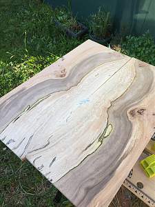

    In other news, I ordered this great piece of spalted Plane tree online a few days ago and it arrived yesterday.
Name:	spalted plane tree 4.jpg
    Now I just need to order the kit!

    Nice looking piece of veneer you have there.
    One thing you would need to do before settling on a bridge is to find out the string spacing required. Hopefully Adam should be able to get the information for you but I suspect it will be a narrow spacing. That Schaller roller bridge is adjustable, but most of the others are fixed width, so you'll need to make sure you get the right one.
