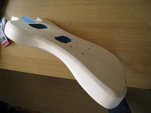

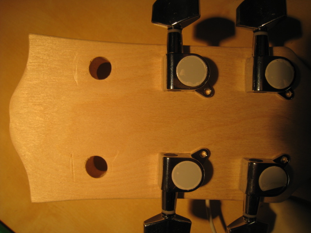

    There is, however, someting wrong with the headstock : the top two machinehead holes are misaligned by a couple of millimeters. Beside any aesthetic consideration (it's not THAT noticeable), I hope this won't have any effect on the playability or on the tuning stabilty of the guitar. Has any of you ever experienced this problem ?

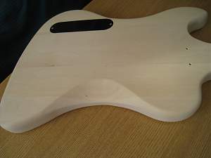

    Apart from that, I've started gouging away some of the body for a belly cutaway. Also, the Gibson RDs I've seen have a much more angular shape, the body edges on the pitbull kit are much more rounded. So I've started altering the upper contours on the body using a powered sander, although I'm not sure about what I'm doing. I don't really have woodworking tools at hand, so if anyone has advice for me on how to proceed, I'd be very grateful

    Misaligned tuner holes are a known issue with these kits, but it’s normally the 6 in a row headstocks. Are you talking about the middle ones being slightly more inboard than the end ones? Because that is normal on a paddle headstock. If it’s botheri you, it’s pretty simple to glue some dowel in and re drill. They normally only need a mm or so, so any evidence is covered by the tuner and washer.
    I can see what you are saying, the top two tuner holes are different distances from the edges. The mids look right as do the ones closest to the nut but the top two are definitely out.
    That’s a definite dowel and redrill job unless you want to flick it back to Adam, or forget about it if you can put up with it.
    Personally speaking, even the photo of it is giving me a tic, so I’d be cutting the plug for it as we speak. 😵😂
    Last edited by FrankenWashie; 11-12-2018 at 05:21 AM. Reason: exceedingly poor grammar
    To be honest, it took me a while to notice it, and that was after I removed the machineheads. Plus I'm not confident enough to re-drill the headstock (I can already imagine a potentially catastrophic mess !) so...I'll keep it like that and work on a couple of other things instead. Thanks for your advice anyway

    Depending on where you are there may be a better equipped forum member who may be able to help you out with it. If you can deal with it as is then all good.

    Despite currently building my 2nd Pitbull kit, I consider myself a veteran in drilling/re-dowelling.
    It doesn't require a great deal of skill.
    A bag of 10mm dowels and some Aquadhere.
    The filing done with a coarse rasp, however the Dremel 'grinding kit' did speed up the process.
    Once done you'll be asking why the hesitation.

    It's been a while since I last posted here. Having no workshop of any kind at home, working on my guitar on the dining-room table is always a bit of a pain... So this is taking me quite a long time, but then I expected it to. Ok, on the plus side, I've managed to contour the body, or the upper half at least, and I think it looks cool as is, so I'm going to leave it like that.Click image for larger version.

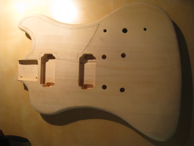

    Oh, and of course, I drew and cut a pickguard, which was harder than I expected. The shape was really not that easy to get right... It still isn't perfect, but I still have some 3-ply plastic that I can use should I decide to make another one. Click image for larger version.

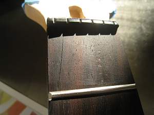

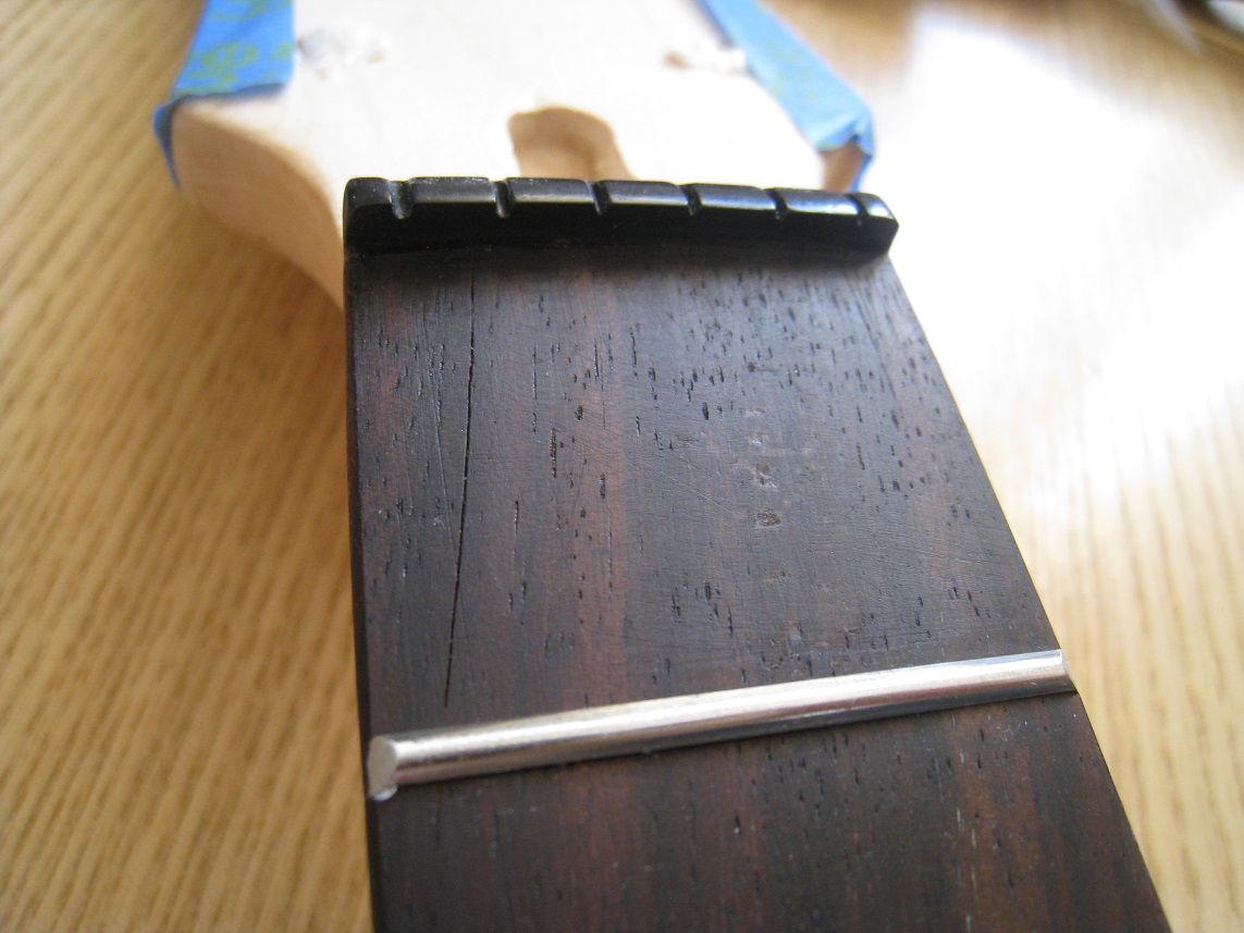

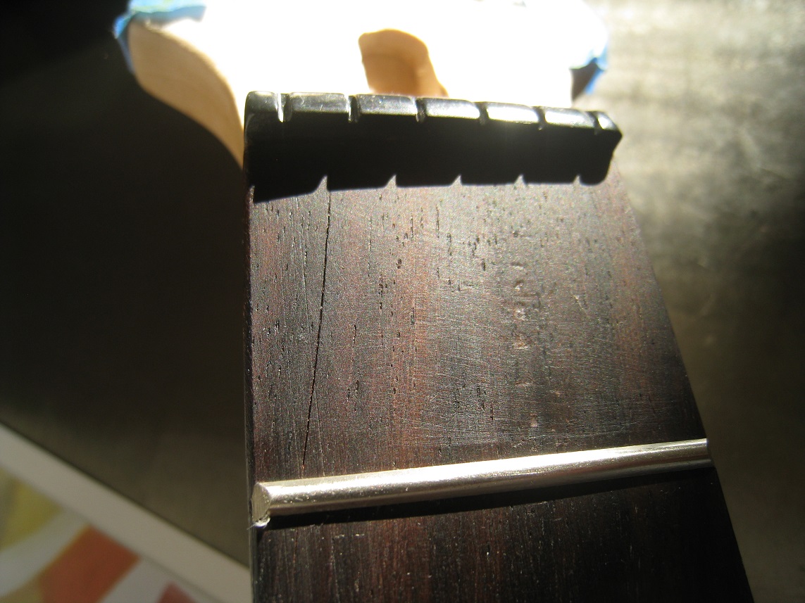

    However, as soon as I turned my attention to the fingerboard, I noticed a couple of things. First, the wood between the nut and the first fret is badly scratched, and there is a long crack (a couple of inches). It looks bad, and I only saw it once I had started oiling the fingerboard and it had become darker. The scratches I can live with, but the crack... Click image for larger version.

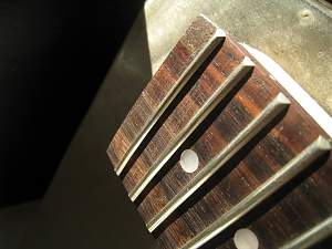

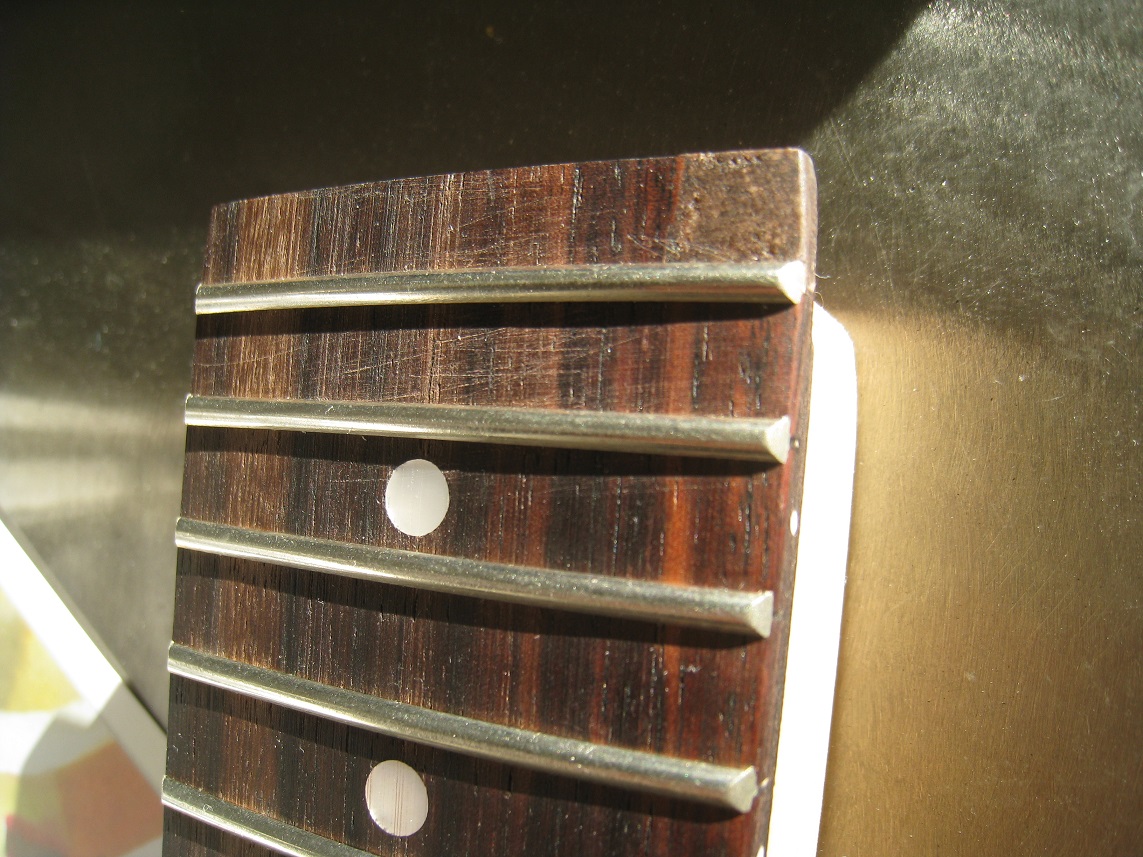

    And that's not all, the OTHER end of the fretboard is also badly scratched between the 20th-22nd frets, and the wood appears to have been chipped, like there's a whole square of wood missing : Click image for larger version.

    So, a couple of questions for you master-builders out there (you know who you are ) : do you think that crack in the wood is going to affect the playability / stability of the neck in the long run ? Aesthetically, I think it's really problematic, but is there anything that can be done about it, or should I ask PBG to send me another, less flawed, neck ?
    Here are a couple more photos : Click image for larger version.
Name:	Fretboard crack2.jpg

Name:	Fretboard scratches2.jpg
