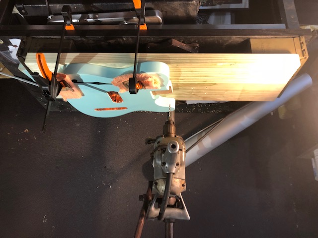

    Now I’ve got things in front of me there’s a few things I’m realising;
    -drilling holes through the body to match pre existing holes in the neck is gonna me a nightmare, I know the holes through the body are big enough for the screws to slip through though so hopefully that gives me a little forgiveness in measuring?
    -without either the neck OR the bridge positioning being locked in place the geometry of this thing is up in the air, like, I’m assuming I should attatch the neck then use that to find the right spot to put the bridge?
    Before anything else I wanted to get the painting going cause I know it’s gonna take forever. In fact a few days in and I can see the appeal of a natural finish haha. So I know I’ve still got a the bridge routing and through holes to sort out, and the pickup cavity needs a little squaring off to make way for the t60 pickups, but here’s a couple layers in;

    I'd make a template of the back of the neck to get the hole alignment, use some tracing paper or something and then use that in the cavity to make sure they all line up. And yep, get the neck on first and then measure for the bridge. If you temporarily install both e string tuners and then use a piece of regular string through them to the bridge you can quickly work out the centre point. Then you jsut have to make sure there is enough room for intonation adjustment. You want 648mm from the inside of the nut to the high 'e' saddle as a base starting point. All the thicker stings will be slightly longer so allow for that adjustment.
