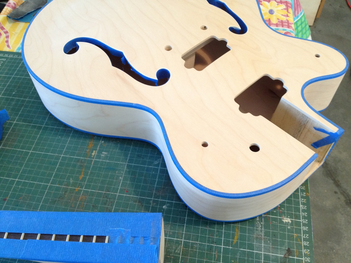

    Before application I had done all the sanding, vacuuming off the dust and masking the binding. I saw a guy online make thin strips of tape by clamping a craft blade onto a small stack of cards and turning the roll of standard tape around against it. Worked a treat and saved a lot of scaping colour off.
    Staining finished now. In the oiling with Tru oil process. 4 coats on so far. starting to look nice.
    Picks attached.
