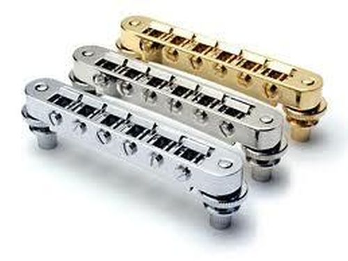

Traditional ones....

The humble G style Tune-O-Matic has been around forever and I have never swapped one out or upgraded on any kit or store bought guitar. Usually there is just enough fore & aft travel to do string intonation but sometimes flipping the direction a saddle faces can provide a few extra mm's to play with. Biggest limitation is everything being held rigid in one plane where the only vertical adjustment is from outer posts at either side.
