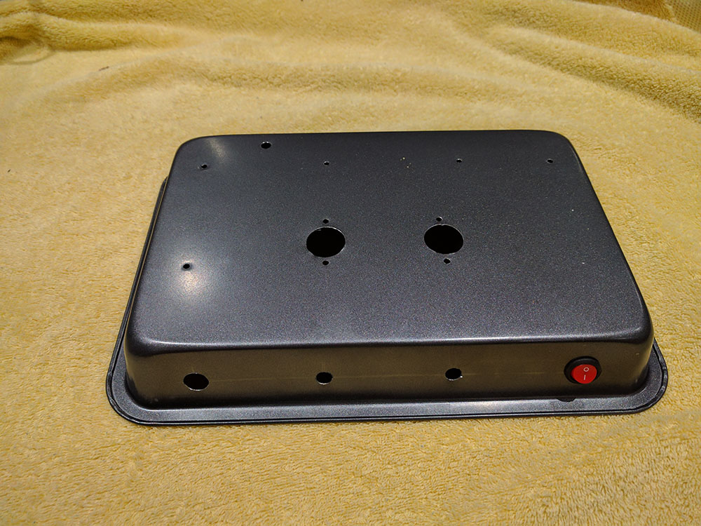

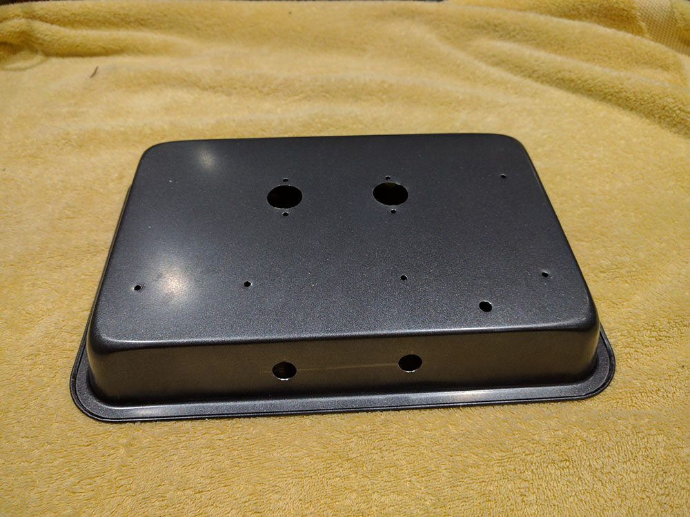

Name:	2017-05-04 18.09.37.jpg
ID:	19293Click image for larger version.
Name:	2017-05-04 18.09.44.jpg
    The chassis as supplied

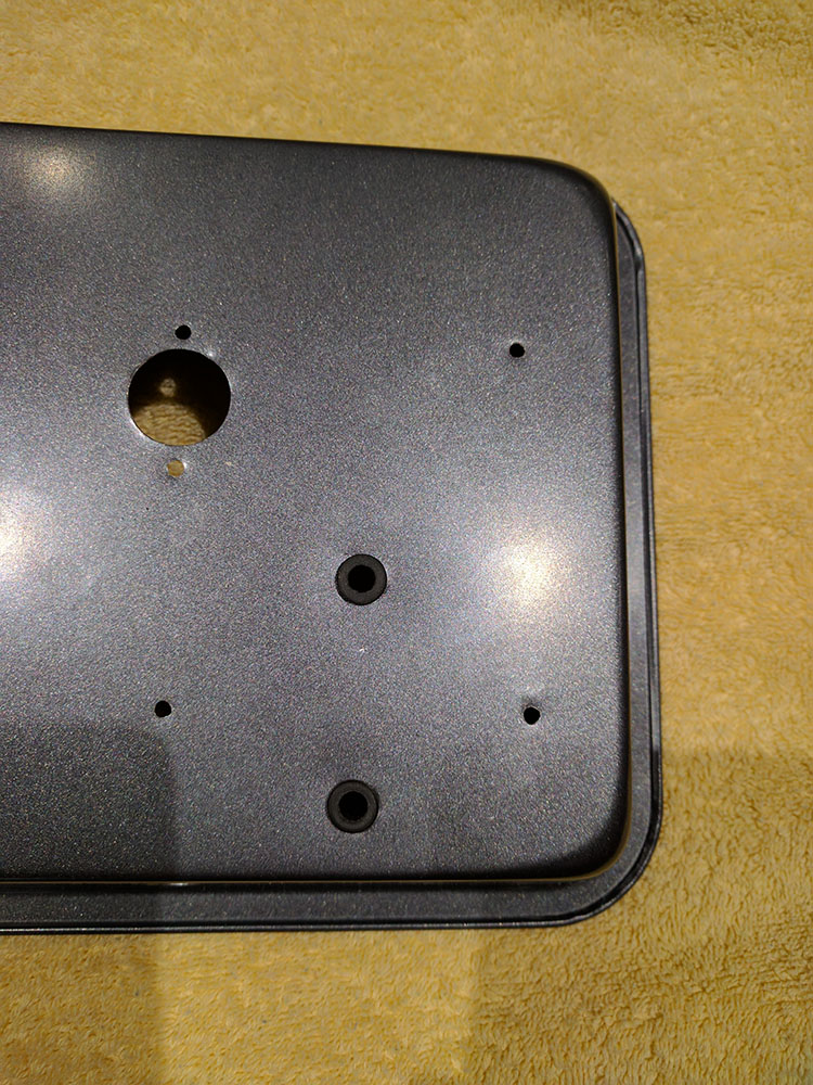

Name:	2017-05-07 16.16.31.jpg
    one of the holes was missing as well the grommets (the other kit has them) so I bought some grommets from clark rubber and drilled the missing hole and enlarged the other one to fit the grommets. Drilling the thin sheet metal proved to be a challenge and while the end result wasn't pretty, the mess was covered by the grommets.

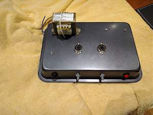

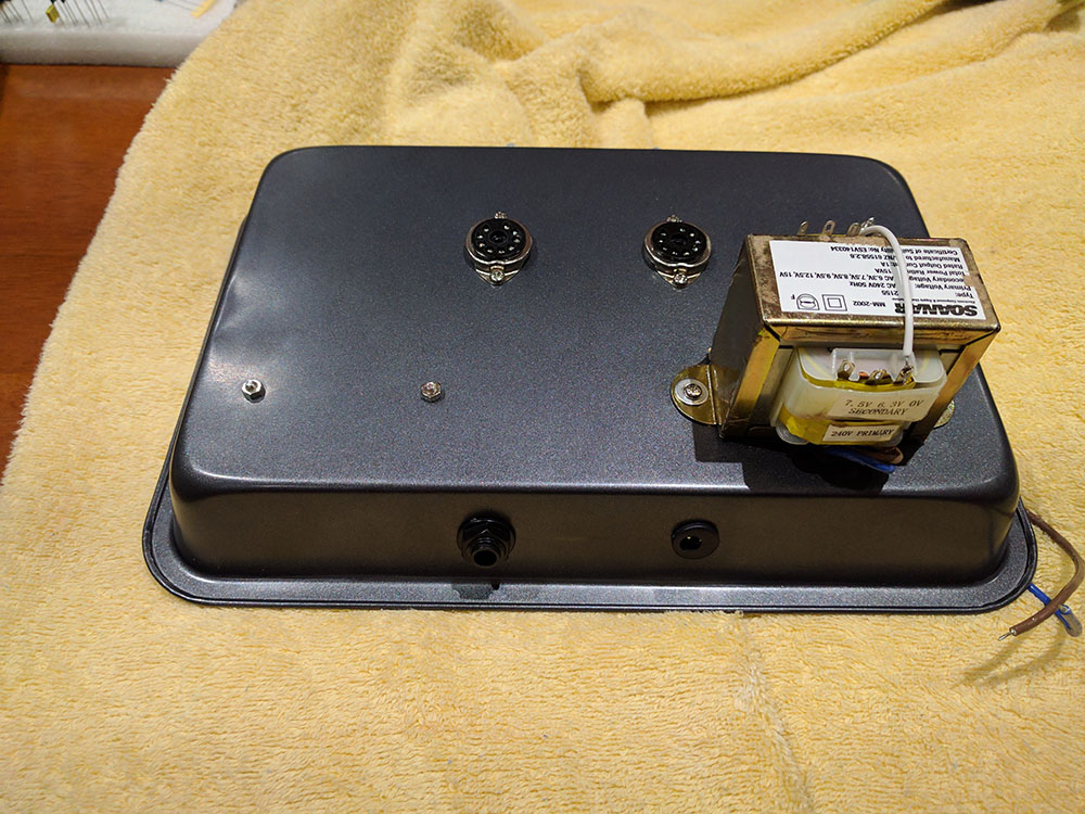

Name:	2017-05-08 23.12.59.jpg
ID:	19296Click image for larger version.
Name:	2017-05-08 23.13.12.jpg
    Hardware installed and the first wire started. I need to get an underside shot which I'll do tonight.
    I decided to stick with the supplied pots as getting the 500k pots with the same hole mount size was a pita.

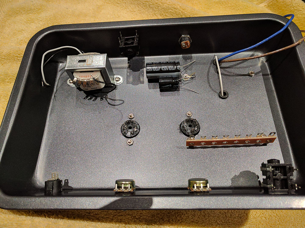

    Here's an underside shot having installed the hardware and just getting started on wiring the power circuit:
Name:	2017-05-14 15.54.00.jpg
    looks good Maddog. Are the instructions pretty easy to follow ?
    Yeah, so far. The main issue I've had was when they referred to the missing grommets. They do require reading ahead a bit so you have an idea of what a current step interacts with. It includes testing as part of the process as well as schematics and wiring diagrams which help you visualise what the steps are describing.
