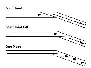

    The gibson method is to cut the neck from a single blank so that you end up with short cross grain through the headstock/neck transition.
    Scarf joints are much stronger than this as you've laid long grain structure in a much wider contact area. The long grain runs down the headstock perpendicular to the tuner shafts. see below:
    In all of the scarf jointed necks I've made, i use the top method as i feel its easier to achieve a strong joint this way, and its can be done from a 1' /25mm board, rather than a deeper block of wood.
    The G company uses the bottom method, which gives you that short grain weakness, then they cut a TRC adjuster cavity into that already weaker section. That is the genesis of G's reputation for headstock breakage according to everything i've read.
    Ah well there you go, I guess I assumed that since all my guitars with that style of head stock are scarf that the Gibsons would be as well... Seems a bit odd to do it that way from both a strength and wasted material perspective.
    Yeah but they’ve been doing it that way since forever and they won’t change because it’s “tradition”. Possibly part of the reason they have the issues they have at the moment.
