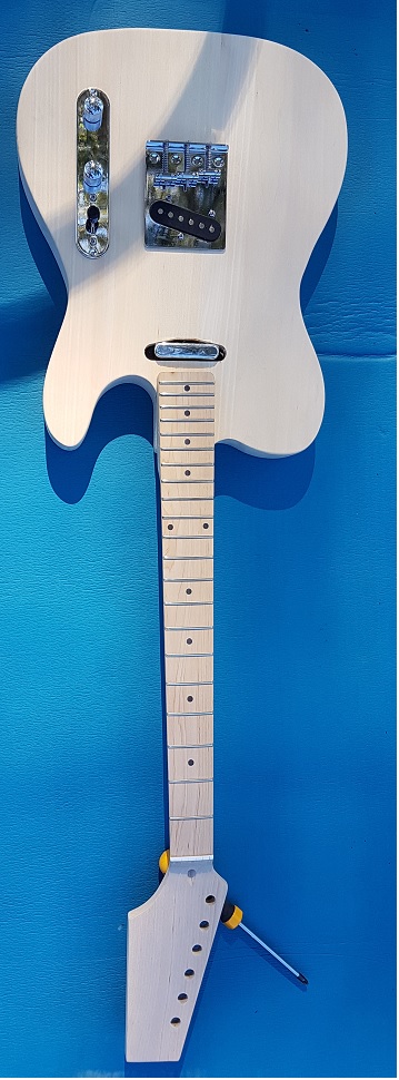

    After jumping in and ordering the Tl1 Custom order that went wrong last month, finally get a chance to unbox and have a look. Was a birthday present so only got hold of it on Tuesday.
    plans for the moment are something like,

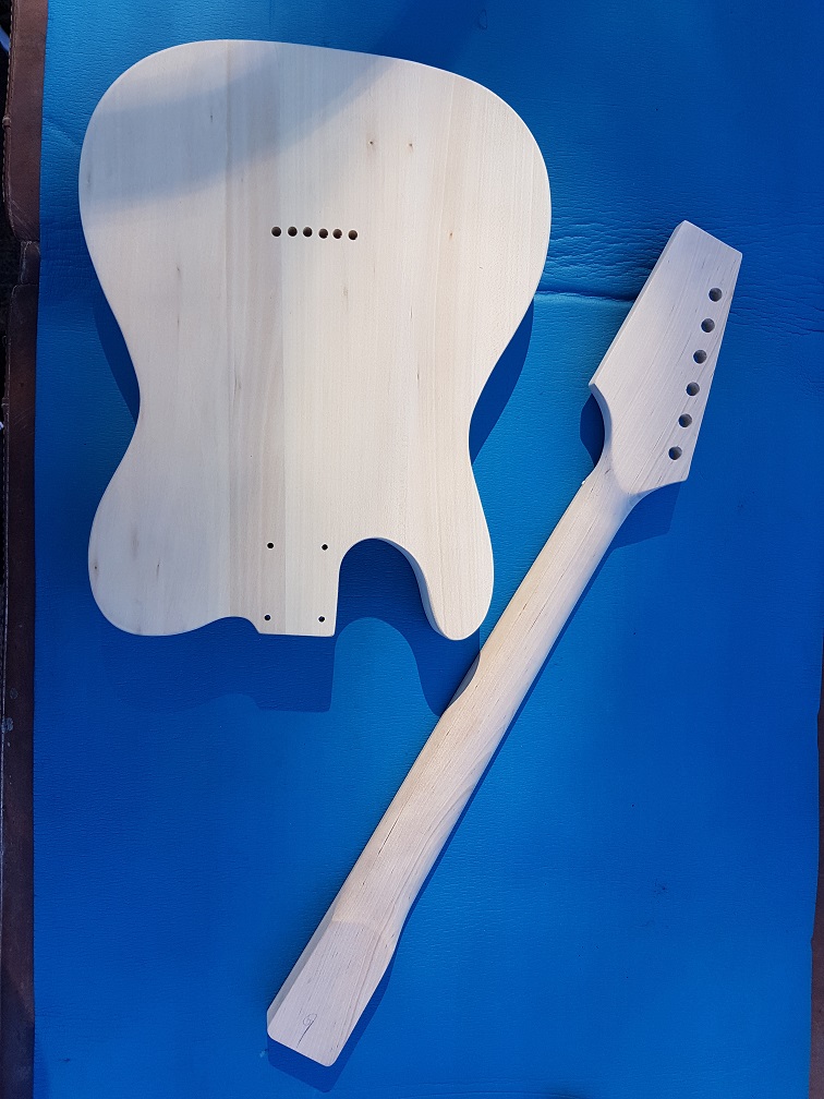

    Mocking it up, the body is really clean no dings or marks that I can see at the moment,

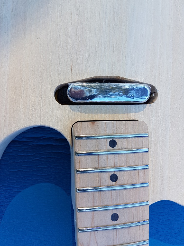

    Only concern is the neck pocket. haven't done a bolt on kit before but it does seem a bit lose, going to be a gap that needs filled. Normal?

    I used some copper shielding tape to tighten the neck pocket on the Strat build, worked a treat
    interesting, you have to build up layers, or did one do it for you? Sounds like some experimenting will be required.

    Quote Originally Posted by Rossc0 View Post
    A couple of layers on each side gave a very firm fit, a case of add as required
    Visually, the pickguard should hide any gap - unless the pickguard and the end of the neck don't have the same shape.
