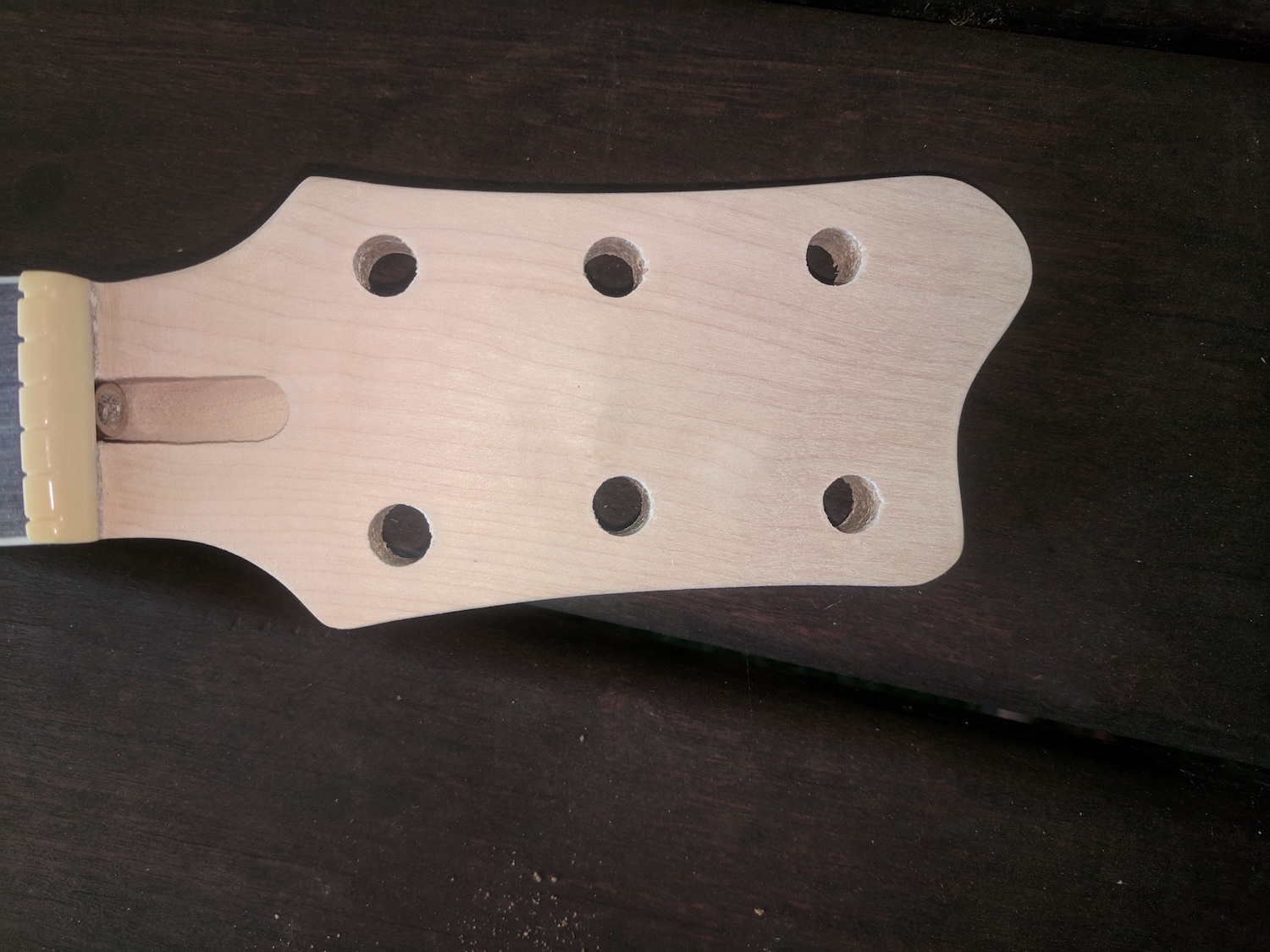

    I took a saw to my headstock and also repaired a ding in the bottom of the neck. Spent the rest of the day sanding and am now getting close to adding some stain.

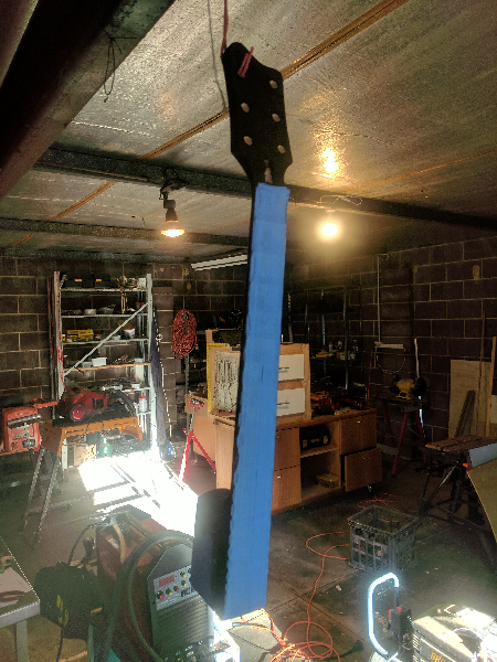

    Spent last weekend sanding & sanding. Turned out it still wasn't enough!
    This weekend I started adding some colour, the pics are early on, it's looking better now. I used UBeaut water based stain for the front & back & Feast Watson jarrah for the sides & neck. The water based dye is very forgiving but it does raise the grain a bit. I found it wasn't a good idea to follow the instructions to wet the surface first, it pulled the grain too much. It worked much better to add the dye to a dry surface in sparing amounts & really work it in.
    I was a bit disappointed when I first added some colour to the neck, the 2 different types of wood either side of the skarfe joint absorbed dye at wildly differing rates making the joint really obvious. I always intended going really dark so after a few more coats it doesn't look so bad now.
    I'll leave the dye to dry for a few days now before glueing the neck to the body. I'm thinking of using tung oil for the final finish, i've used it on some cigar box project & liked it. Has anyone else used it?

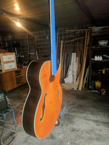

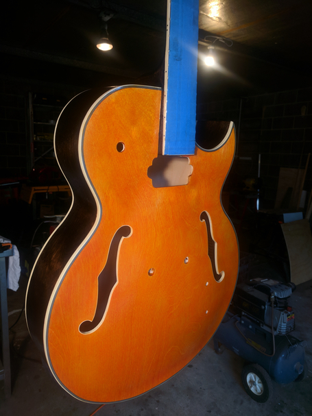

    Started with some oil. Decided on Tru Oil in the end. 3 coats so far, several more to go but I think i'll try a light sand with some 1500 wet & dry before the 4th coat.
ID:	25570   Click image for larger version.
ID:	25571   Click image for larger version.
