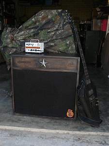

    if you can find an Orange Micro Terror (not the Dark version which is a lot more gainy) they are a cool little little amp (valve pre-amp, solid state power amp). You will need a speaker however. yay new project!

    2,822
    One of the most absurd rigs I have seen is an Orange Micro Terror sitting on top of a Marshall quad box, sounded surprisingly massive
