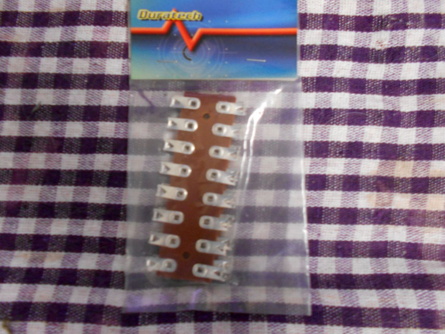

    Update:
    Last year I bought a Grab Bag of bits and pieces from Jaycar Electronics, and inside it I found two packs of 8-way Tagboards in it which look like this:
Name:	8 Way Tagboard_resized.jpg
    Each pack contains two 8-way Tagboards in it, anyway, been doing some thinking about what I would use to mount all the parts, minus the valve socket, pots, etc on and thought that it would be cool to try something different and go for a Tagboard/point-to-point construction method for the 3-Knob Tube Driver pedal.
