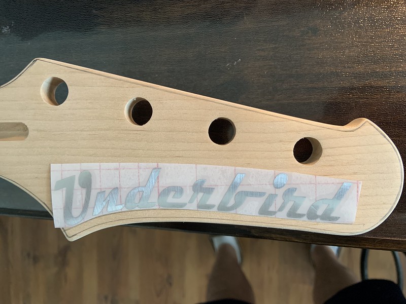

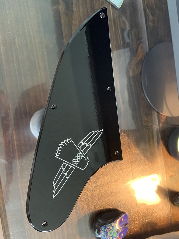

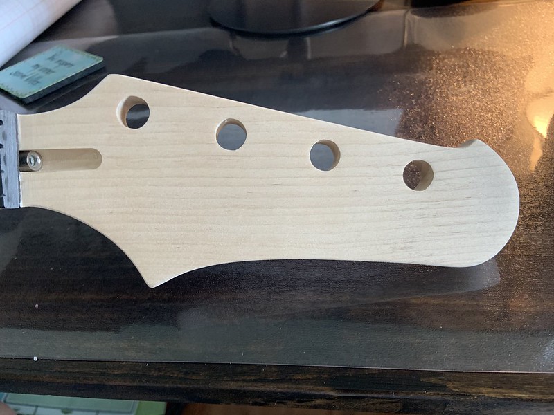

    Hello all! my name is Jeff from the USA. This is my first build of a guitar and im anxiously excited. I have already made some progress with the kit. I fit the neck and made sure all the measurements were correct as per the instructions. I just laid down another coat of primer on the body as it will be painted like a candy apple red. I have also painted the pick guard metallic black and cut a sticker of the Thunderbird logo. I sanded the neck and headstock and added a little more curves to the head. The back of the neck and headstock will be a dark gray/black stain with a matte finish and the front of the headstock will be red to match the body. Enjoy the pics! Thank you all.

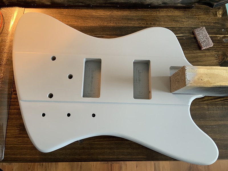

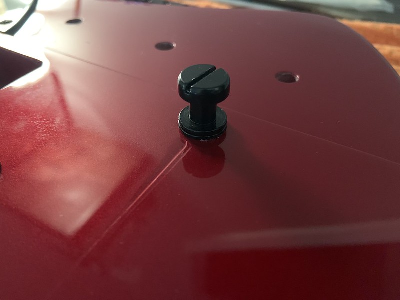

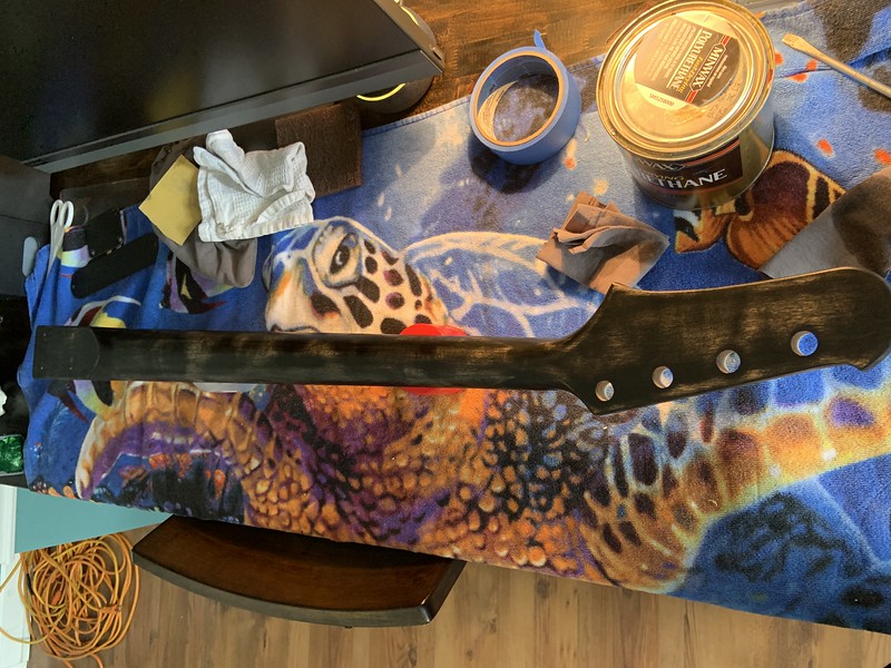

    Thanks for the comments guys. Heres what I have been working on. I got the back of the neck finished out and letting it dry good before painting the front of the headstock. I also made a sticker for the front of the headstock and got the body in primer. Thanks for looking.
