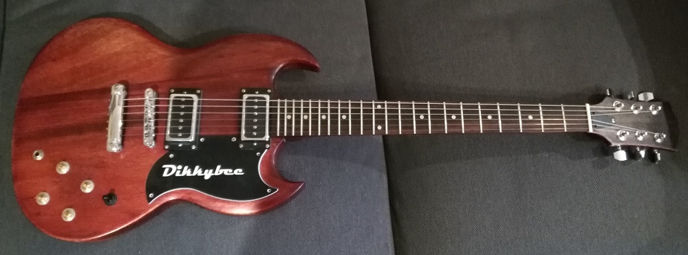

    With this build you get 2 for the price of 1. The finished guitar I did about 5 years ago with a kit from another Australian website before I found Pitbull. I replaced the original humbucker pups with a set of Agent 90's from Realparts and finished it in a cherry stain which seeing as this was my fourth build after my 335 I was happy but now after a few builds I am not and want to change it to look the same as the SG bass I got from Pitbull. I am going to replace the pickguard with a full guard which means partially plugging the neck pup cut-out and putting in a new one. I am going to paint it black and replace the tuners with some original Klusons so it looks a little more like a store bought and not a generic kit.It plays and sounds good with the exception of the frets which were finished incorrectly when I got it so I may change them and redo the nut. When playing the high E has a tendency to slip off the side when doing pull offs due to the fret ends having too much angle.

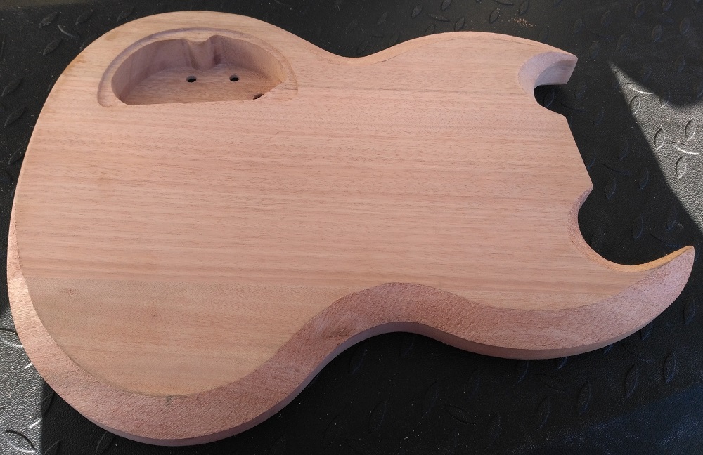

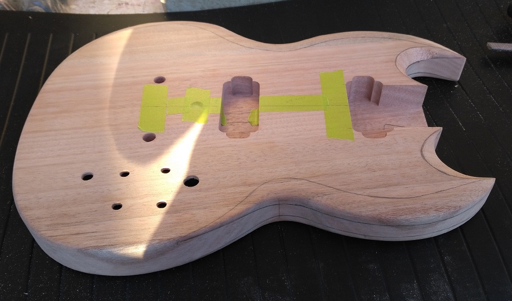

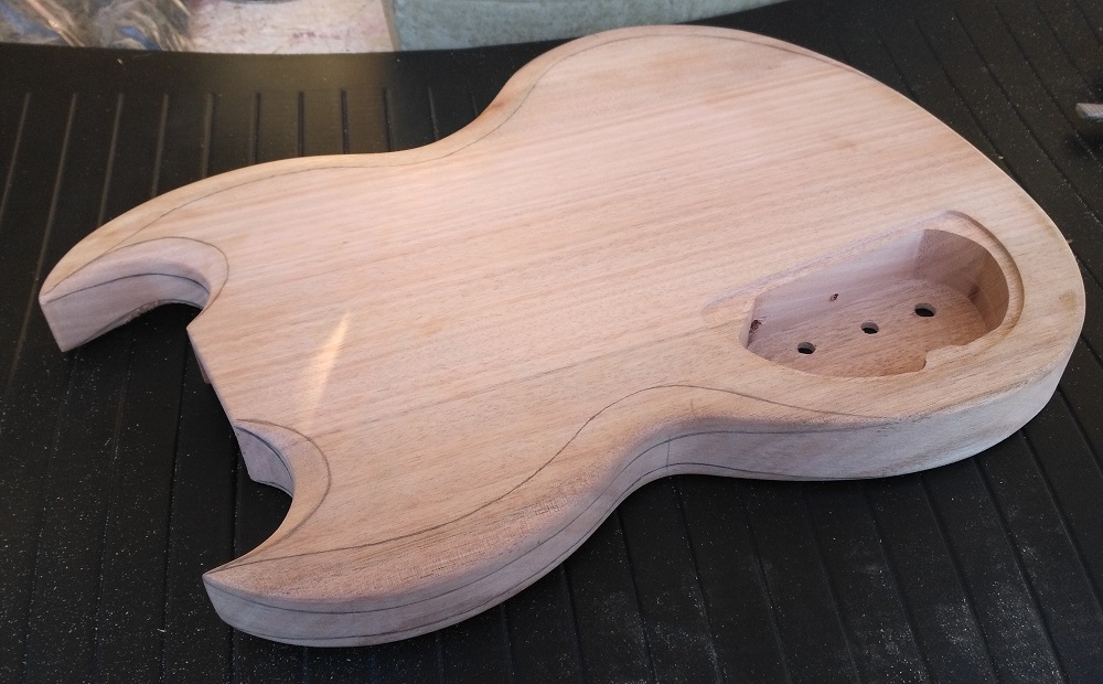

    As per pictures I marked out the side bevels last night and went shopping this morning and got some wood rasps and roughed the bevels. Will finish the bevels with files and start sanding and put a radius around the outside. Once I have finished I will then strip the hardware off the guitar and put the same bevels on it to match the bass.

    looks good with the heavy bevels Dickkybee. So that's pics of the SG guitar, are you building a SG bass as well ?
    Hell yeah, bevels look awesome! Sanding them is tons of fun too [sarcasm].
    Wyndham Vale
    143
    Sorry about the confusion. The bass is an unfinished Pitbull kit which I started last night and the guitar is a finished playable guitar that I finished about 5 years ago. I am going to redo the guitar so it has the same look as the bass. I will be doing the same bevels on the guitar as I have on the bass so the only difference will be the number of strings. When I finished the guitar I rushed it a little bit just so I could play it and it just didn't finish as well as I would have liked it so after getting the bass I thought I would redo the guitar to get it to where I should have got it in the first place. I really don't like the finish I got on the guitar and now I want a gloss finish rather than the matt. It needs some work to the frets as I never levelled them as I had no idea about how to setup the action so I had to try and strike a compromise between being able to play it by having a high action. Unfortunately since then I have found I like as low as possible action so I have to do some work to get it to where I like it. I was thinking of replacing the frets with maybe some jumbos as I do like the higher frets so I would have to replace the nut. Since I started doing the kits I have learned so much about guitar setup and all my earlier guitars will all be getting a refinish to where I like them. As for the sanding I am retired so I can have as many nanna naps as necessary and if aint done today it will be done at some later stage as there is always tomorrow.

    Good to know. Haha. Just be aware of the direction of the grain and use a round sanding block (I used a bottle) to get into the inner horns.

    Great to see another SG with wider bevels. Had a lot of fun reshaping mine! And I reckon that's how all the SG bevels should be!
