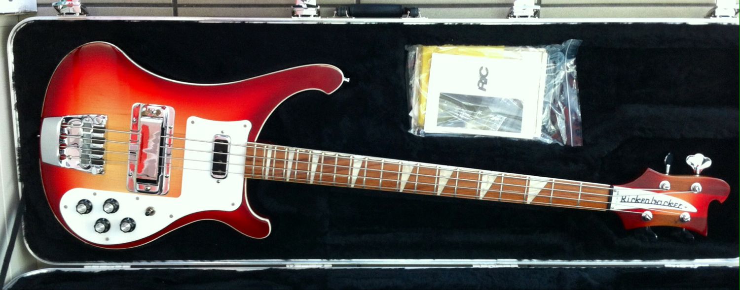

    Hi Bill, I played around with stereo setups about 32 years ago when I had a Ric 4001 and also wired up my fretless yammy BB1000 stereo too. Unfortunately both those Basses were sold long ago but bought a Ric 4003 12 months ago and loving the flexibility of playing mono or stereo with it.
    To wire same as Ric-o-sound where you have 2 jacks may not be so easy and suggest waiting for Scott aka Weirdbits to drop by and offer some advice. Either way you will need a stereo output jack and a splitter to run 2 cables to the separate channels or separate amps. On my yammy I replaced the mono jack with a stereo, dropped the tone control and ran with 2 x volumes instead. Doesn't help if to want to play mono as only 1 PUP is in the mix, can't remember which one but it comes down to what is wired to the tip I think. Splitters are not too expensive and I bought one for less than $20 at a local music store.

    Thanks Waz, that Yammy sounds like it would have been very interesting!
    & I can but dream of a new 4003
    Any chance of a pic?
    Quote Originally Posted by billb View Post
    In the middle of editing a video demonstrating mono & stereo and should have that posted sometime this weekend.
