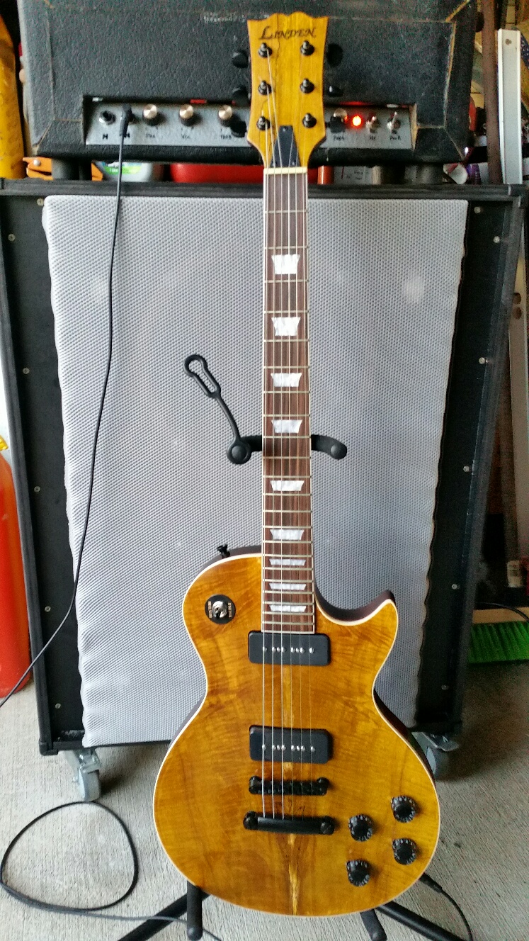

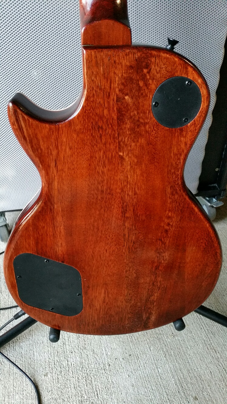

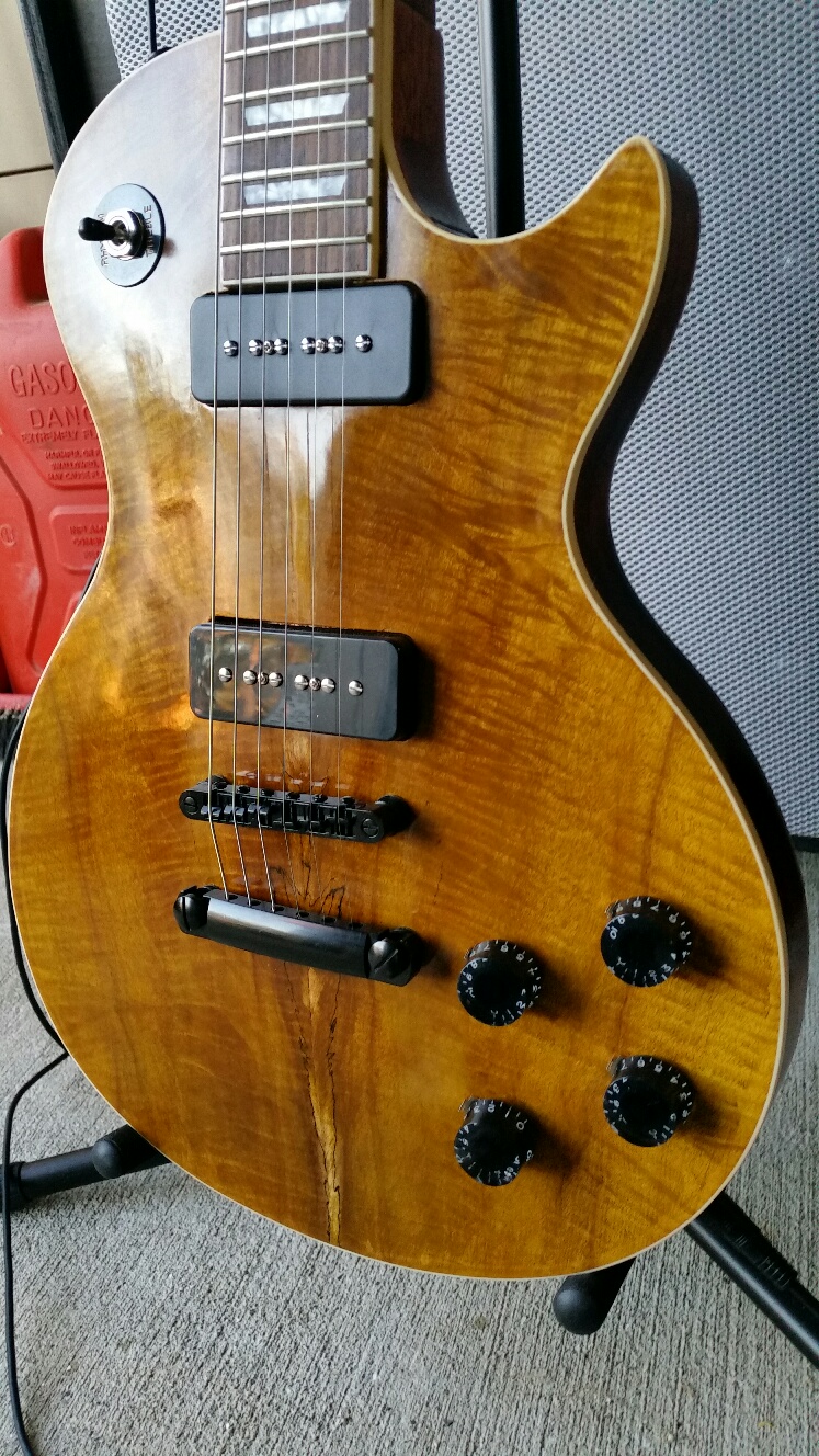

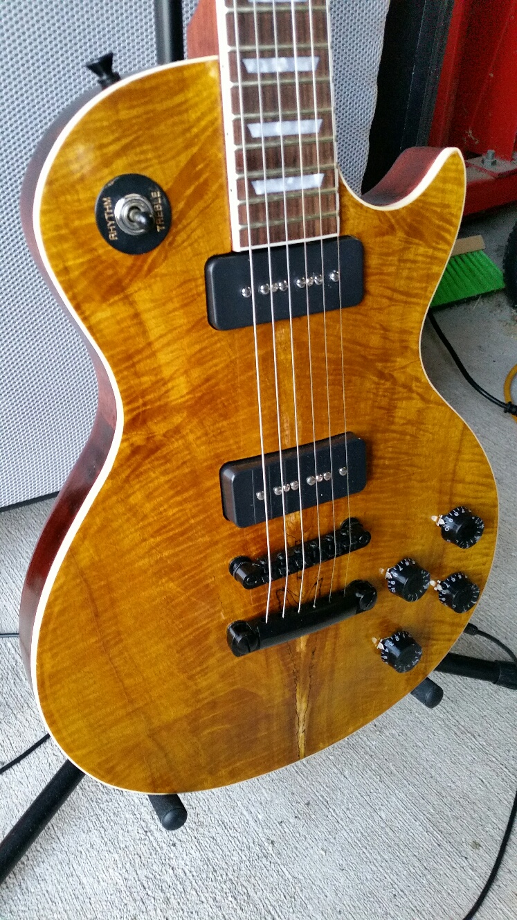

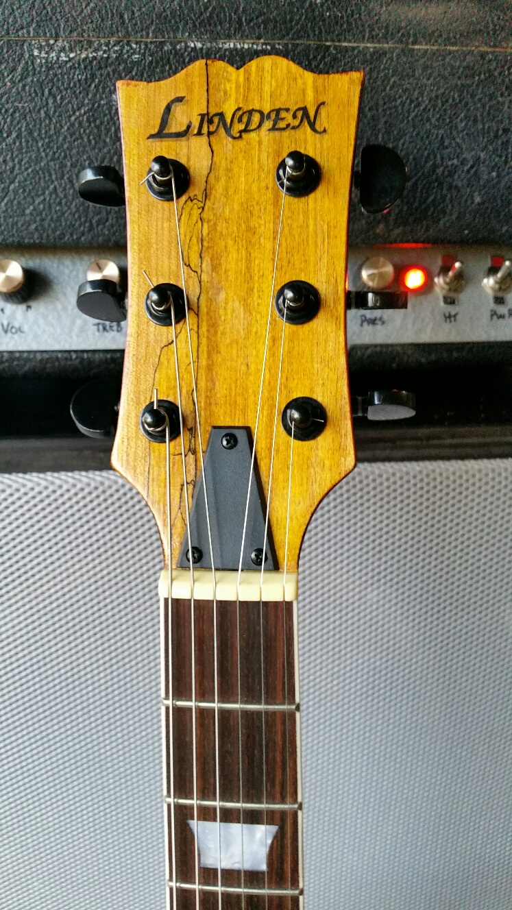

    Marcel's PBG kit LP-1SSP (Kit Purchased via Ebay 14/04/2017. Completed and playable 4pm 15/05/2017)
    This guitar build boasts the following....
    French polished Shellac on all spalted Maple that has been coloured with my own mix of Yellow & Brown Keda dye, then U-Beaut wax buffed to shine.
    FW Jarrah stain on all Mahogany then covered with 2 coats of BC sealer filler and then 4 coats of BC Tru-oil.
    Push back cloth wiring (A.k.a .'50's style wiring) on all signal paths.
    Earthed Copper foil under/in both pickup cavities and under volume/tone controls.
    Brown drop 0.047uF caps.
    PBG neck P90
    Yibuy bridge P90
    Standard PBG kit tuners, knobs, bridge, switch.
    Nil fretwork required so far and nil fret buzz.... Some players might want a little work on the nut but I'm okay with it as is...

    Hmmm, very nice. Would love to hear how it sounds with those P90's.
    Cheers, Waz
    Mentor Marcel's Avatar
    Apr 2017
    Bouldercombe Qld.
    1,168
    Waz...
    Seriously.... I simply got blown away.!!!
    My P90 loaded girl sings to my heart... Clear tomes with plenty of harmonic content.... Through the home brew JTM45/2204 amp set to clean and the Celestion Vintage 30 and G12H75 loaded cabinet behind her I could almost believe I was listening to an acoustic guitar, but way much louder.. This girl is the best sounding build I've done so far and IMHO sounds sweeter than my Gibson '50's tribute...
    Haven't tried her on dirty or crunch tones yet... That will only have to wait until I introduce her to Mr JVM210C in the very near future...
    Damn, that's pretty. That top hasn't got much going on in the way of spalt, but the flame! The flame!
    great looking build Marcel well done. Keen to hear a sound demo of the P90's
