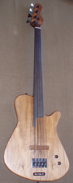

    FlyHog85’s post about accidentally tuning his guitar too high and wondering why he was breaking strings made me think about one of my great bonehead plays when building.
    On my first bass build many years ago everything had gone perfectly… until putting everything together. I excitedly went about installing the bridge, measured twice, then happily started drilling holes. Got the bridge on then strung it up, and wondered why the strings seemed short? Couldn’t work it out for the life of me. After working through every possible reason, I finally decided to remeasure the scale. It was 36 inches! For some reason I’d got 36 in my head as the standard long scale length. God knows why! Afer a few choice words to myself I redrilled and all was good – but there were four holes sitting behind the bridge. I eventually covered them with a “logo” (you can see it below), and now it serves as a constant reminder to keep a clear head and take your time when building!!
    I think it’s good for people new to building to know that everyone makes mistakes – sometimes really stupid ones! – but all you do is move on and come up with a way to fix it.
    Anyone else want to share some of their clangers?!

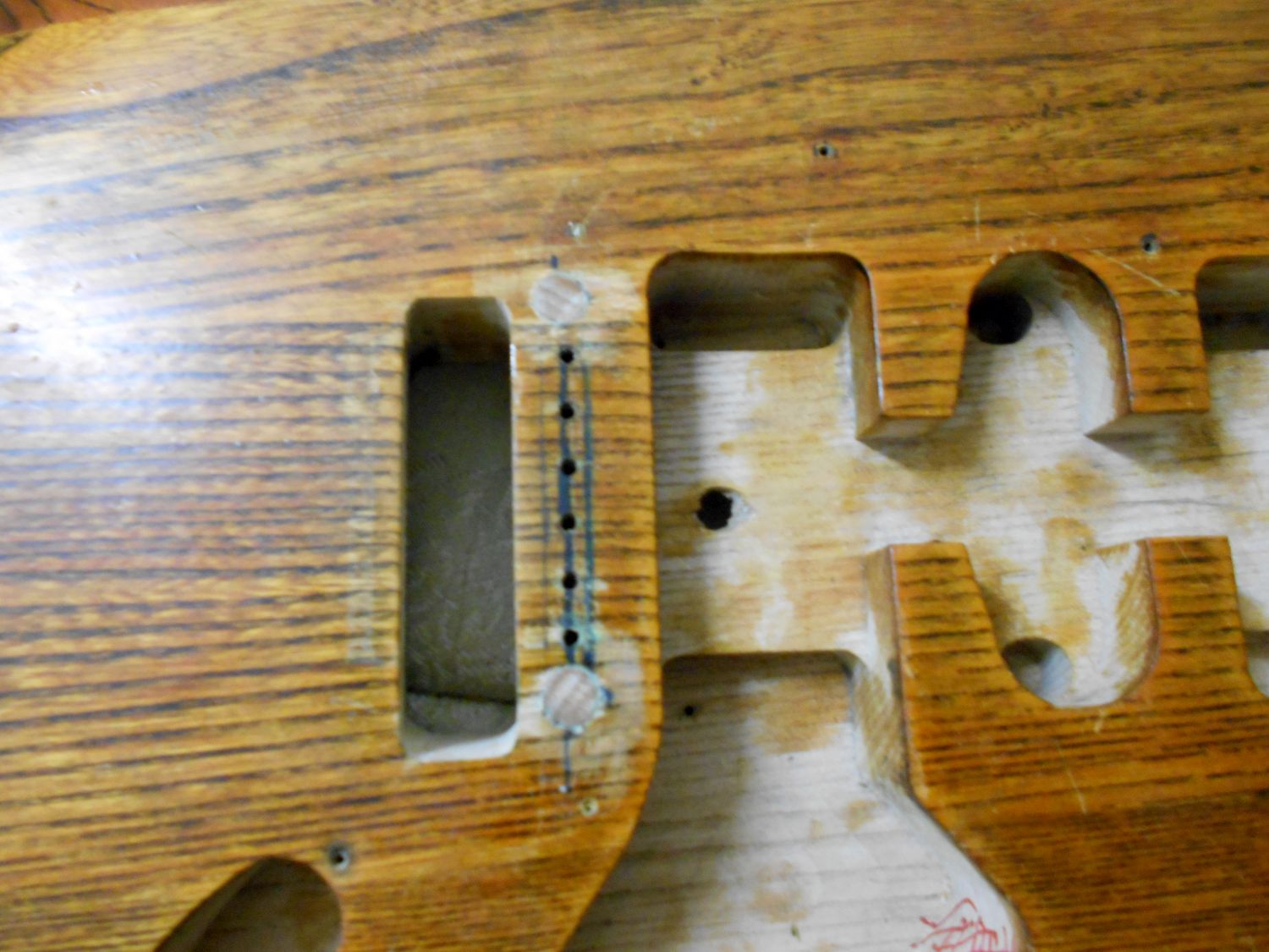

    The greatest mistake I made was when I decided to try installing a Schaller Lockmeister Floyd Trem system on my Gold Strat, everything went well till I went to drill the two 10mm pivot-post holes for the Bridge pivot-posts, I marked out where the centres for the holes were supposed to go, made sure I drilled them 90 degrees with respect to the front surface of the body, then I tapped-in the pivot-posts, it was only when I tried to set the intonation for each string that I realized something was wrong, you can probably see where this is going, anyway, I was trying to set the intonation for the high e-string when the tuner kept indicating that the 12th fretted not was flat compared to the 12th fret harmonic, even though the saddle for the high e-string was as far forward towards the neck as it could go,....and then it dawned on me, I checked the scale length and found that I had drilled the holes about 6mm further away from the neck than where they should have been, making the strings too long by 6mm, you could imagine the colourful language that was going through my mind at the time when I realized my mistake and that I needed to plug the holes with doweling, what's worse was that the only piece of doweling I had was some 12mm Oak Doweling which was too big for the nice 10mm holes I had drilled in the body, to cap it all off, I had to wait till I had some money in the bank so I could get some Dowelling that would fit, the closest I could get from my local Big Green Shed was some 9.2mm Oak Dowelling, fortunately it seemed to do the job, I've got a pic I took after plugging the two 10mm holes I drilled in the wrong place on the front of the Gold Strat body, but I think it's either on my laptop or in my camera's SD Card, will post it here when I find it.
    Here we go, here's the pic I took:
Name:	Holes Plugged 2_resized.jpg
    The blue line that's closer to the neck marks the scale length and is where I should have drilled the two 10mm holes after marking the centres....how embarrassing, considering that I worked in my dad's workshop as an apprentice Fitter and Machinist, I should have known better.
    So, what's the moral of the story here?, measure twice and cut once, but really it should be measure four times, make absolutely sure you have got it right, then, and only then, drill/cut when you are absolutely sure after checking it a dozen more times just to be 200% sure.

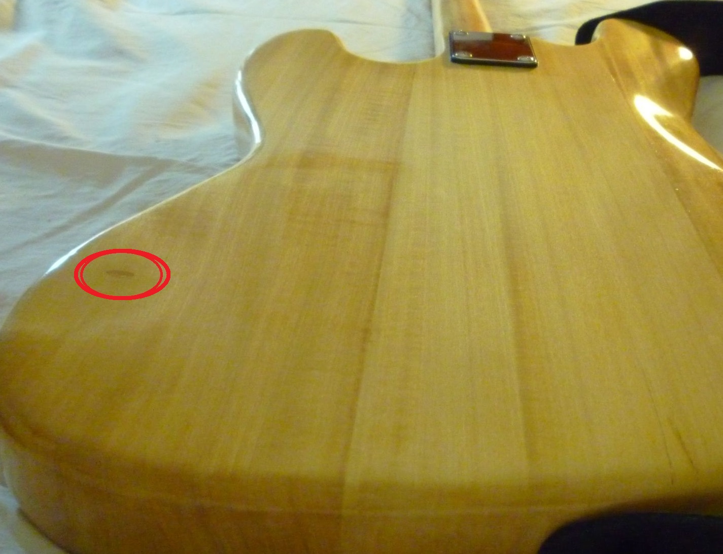

    Second build in - tried to enlarge the hole for the bridge grounding wire - long drill bit in drill - all going well until I came out the other side - entirely missing the cavity I was aiming for. Lesson - wrap the bit in a rag and twist by hand. Much harder to miss...
