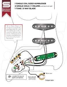

    hello guys, i just build a hss guitar and i'm need a wiring diagram!
    the pickup configuration is hss 1 vol, 1 puss/pull tone and 5 way swich .. i neet to split the humbucker ..
    i hope you can put some clearly picture of the wiring..

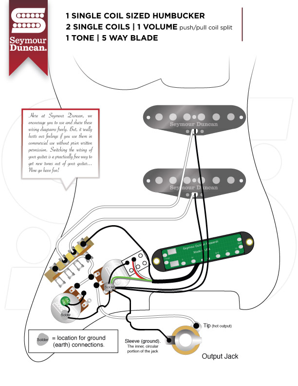

    Just wire it as if it were 3 single coils like in this diagram, and wire your push/pull to split the bridge humbucker the same way it's connected to the series link (the joined wires on your pickup) in this diagram (just the series link and ground connection on the push/pull switch).
    So, same layout as the SSS diagram above but with the series link and ground connection to the push/pull's switch. Make sense?
    it's ok ?
    i have a one 500k pot and one 250k push/pull pot..
    Yes, that diagram will work for your layout. Which value pot you use for volume and tone will impact the sound, so you may need to try them one way and swap them around if the sound is too bright (500K volume) or dark (250K volume).
