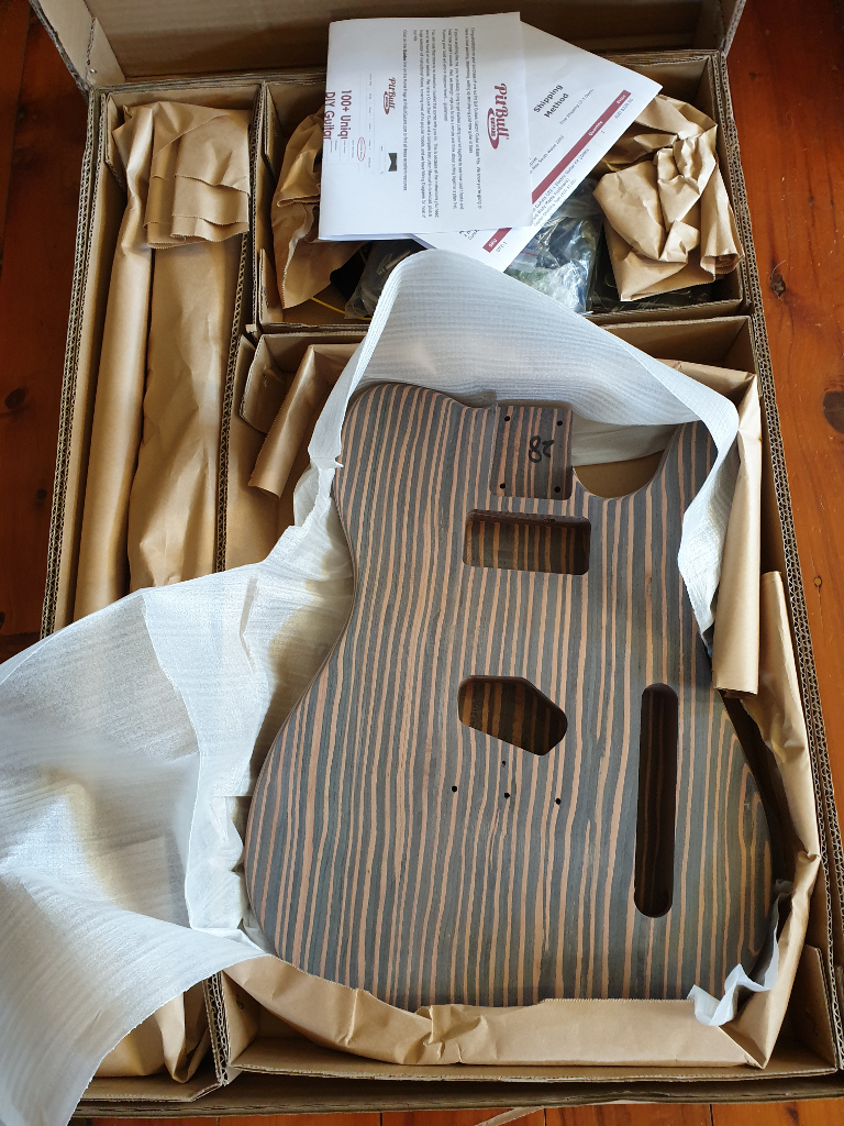

    Thanks for all the comments and tips. I got myself a coping saw. Already have a jigsaw in my arsenal but I'm scared it will be too heavy handed and I'm very likely to stuff it up with a tiny little incorrect movement. Think I'd prefer the slow and steady and the accuracy of the coping saw.
    After sitting at the Aus Post distribution centre 15km away for the past week, the kit finally turned up to my place. Still waiting for the tru-oil to turn up because I stuffed up and ordered Birchwood Casey Genuine Oil by mistake and I'm not willing to risk experimenting to see if it will work. Might just save that stuff for some odd woodwork project in the future.
    Here's the kit just opened up. Sure wish it turned up before that very long weekend with nothing to do.

    I'd be interested to know how much the body weighs if you have a scale that can do that. I do like the look of them.
  11. #9
    I just put the body on the kitchen scales. Body by itself with no hardware etc = 2.24kg
