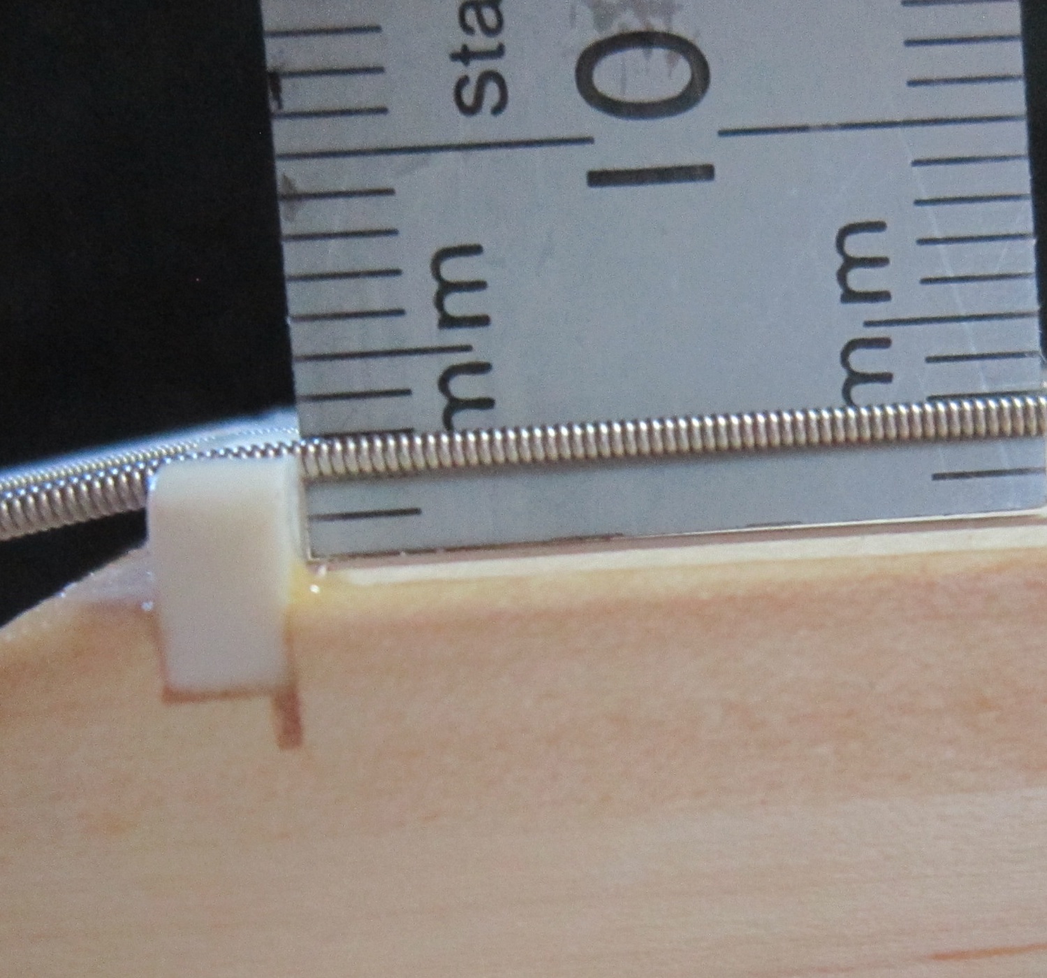

    G'day all, firstly sorry if this has been covered elsewhere. I've been playing for 40 years but never had to set up so...... I've now finished building my TL-1 and I'm now trying to set it up. I've done the action height but now to intonation. I'm using an Eno ET-68GB tuner set on "Guitar" (it has settings for Chronomatic, Guitar and Bass) and 440mz. I've tuned the 6E string, then checked with harmonic and then had to adjust the intonation and its all set. Now first problem is that I tuned the open 3rd, 2nd and 1st strings but when I tried to find the intonation for the 3, 2 and 1st strings the meter doesn't even register. I tried adjusting both ways but no go. I then tuned to best I could and all open strings sounded fine but as soon as I played a basic chord like E G or D it sounded s*&^house. Even though the E6 string is in tune, it was fine when playing E chord but was way out for a G chord. Obviously I've stuffed something up but what? Any clues or hints will be very much appreciated.

    ^ Yep, agreed. Also the nut could be too high, which would make the first few frets sharp even when perfectly intonated.

    As Pablo said I'd say your nut may be too high. Please post some photos of the nut from the side of the neck to show us the string height.

    G'day all, firstly thanks a lot for your input so far. (Hopefully) there is a photo of the E6 string at the nut. From it you'll be able to see that the string height is just on 2mm. The other strings are A = 2mm, D = 2.5mm, G = 2.5mm, B = 2.1mm, E1 = 2.2mm. Also I bought another bridge last night with the six individual saddles so hopefully that will also help. Sorry Pitbull, I couldn't afford the ones you sell. I also plan to buy a bone nut. Are the ones from Pitbull accurate?

    You don't use a ruler to measure the string height at the nut, and even if we did, that information is useless without seeing the height of the first fret - it's all related.
    Here's the best way of checking nut string height... press the string down between the second and third fret, then press the same string down directly over the first fret. There should barely be a goldfish's pubic hair's worth of movement. If you can see the string moving at this point, the nut slots are too high. If there is NO movement, the string is already sitting on the fret and the slots are too deep. (but that won't be the case in this instance, by the sound of it...)
    You need to do this for each individual string. If they're ALL too high, you can lower it by carefully filing the bottom of the nut. (after removing it, obviously)
    If they're individually high, you'll need to buy some (expensive) nut files. If you intend to make a lot of guitars, it's worth the money, otherwise, take it to a luthier and get them to do it.
    EDIT: Out of curiosity, I just checked my Maton BB1200 with a ruler and all my strings are just a smidge under 1.5mm at the nut.
    So, unless you've got the thickest frets on the planet, I'd hazard a guess that you need to get your nut sorted.
