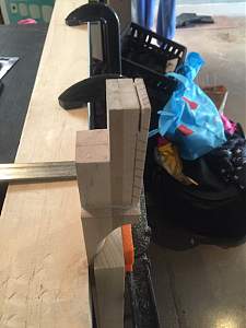

    Here's a few pics from the reshaping of the tenon, it did not all go exactly according to plan.Click image for larger version.
    Not having a band saw of a table saw to rough things out, it was all a case of Measure, measure, measure, Mark, erase, mark and after much agonising, cut. (Then panic, then cut some more then swear then finish the cut, swear again and then realise it isn't as bad as you think)

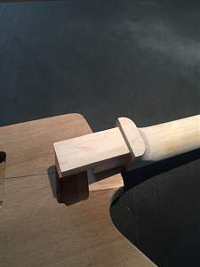

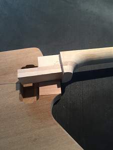

    So I got a rough shape and then proceeded to sand back, clean up, scrape and chisel down to my measured profile, so I ended up here.
ID:	8043Click image for larger version.
    there is still a bit of tidying up to do around the shoulders of the tenon to get a suitable fit, but i'm happy with where it is.
    The next step is going to be measuring out the final tenon shape to make a routing template for the reshaped pocket.
