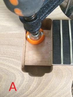

    I have done my mock build and sanded the body, but have come across an issue for clarification:
    When I clamped the neck in place to measure for the bridge (post holes pre-drilled) the measurements worked well when the neck was flush with the space for the neck pickup (Image A)Click image for larger version.

    However, in this position there is not enough room for the neck pickup to fit (as it has a ring mount). When I move the neck to accommodate the pickup, the measurements for the bridge are out by about 3-4ml (Image B)Click image for larger version.
    Having just watched the video link about neck measurements, I am assured that I would not need to cut the neck. So I am not sure how to proceed.
    I am not going to glue the neck in place until after I've stained the body so not a huge rush but it will need to be sorted!
    thanks guys
    It seems to be an issue with the EX style kits Hesh, mine was the same to a lesser degree I managed to squeeze a very thin Gibson original pup ring in there, but it looks like that is not an option for yours.
    You can either trim the end of the neck/fetboard to give you the room, or direct mount the PUPs. Direct mounting is a bit of a fiddle but it can bring great results and a very clean and stripped down look ( refer wazkelly’s EX-1 and EX-5 builds).
    For a first guitar, I’d suggest ditch the PUP rings and hit Wazkelly up for some advice.
    If you want to get a little crazy FrankenLab style, measure up how much you need to take from the end of the fretboard and trim that back down to the neck tenon. If anyone asks, Igor made you do it🤪😉.

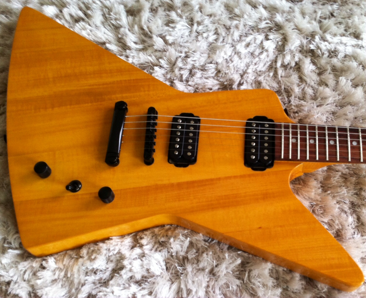

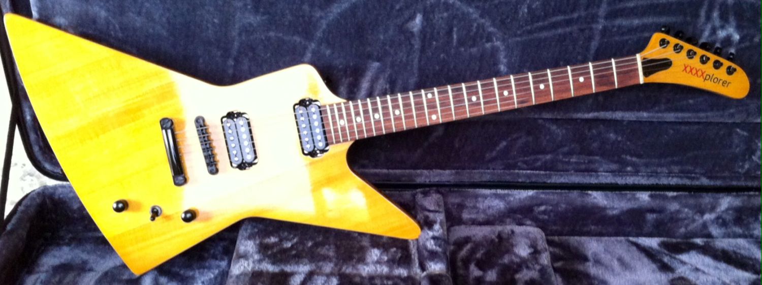

    Hesh, I had the same problem you mention here and ended up top loading without mounting rings. Fiddly job but IMHO looks great.
    Here are a couple of shots to give you the general idea of how it looks...plenty more to be found under that build thread in my signature

    One alternative I seriously considered was buying Rosewood mounting rings so that once the neck one was cut it would blend in with the end of the fretboard and not look so obvious that there was something funky going on.
    Cheers, Waz
